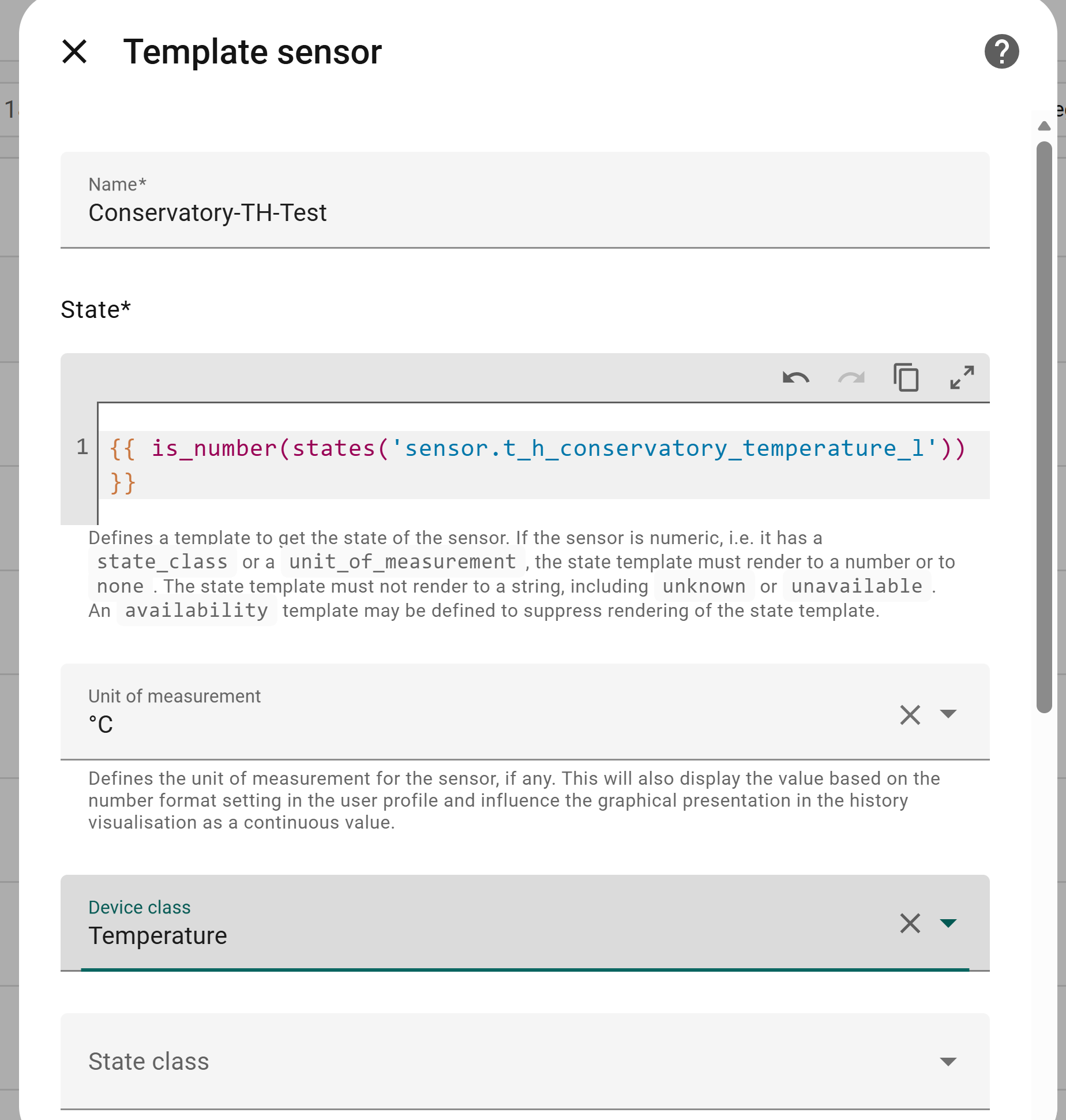

I have virtually no experience of templates but I have one (copied below) that works for me when entered in configuration.yaml but I cannot work out how to write it to be used in a helper template, I get loads of error messages about using YAML.

Template Helpers do not support advanced features like triggers, conditions, or attributes. So you cannot get exactly what you have using a Template Helper. You could get something close by using the self-referencing variable, this, but IMO it’s not worth the trouble doing it that way.
YAML is not supported in the helper config flow, only Jinja templating is allowed in the “State” and “Availability template” fields.

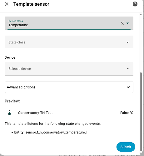

So what’s the difference between a “helper” template and a regular template sensor (besides the extra limitations stated above)? Is there some benefit using a “helper” over a regular template sensor?
It can be created and managed from the UI without dipping into YAML (only jinja).
Another feature of Template Helpers that some users find beneficial is that they can be attached to existing Devices. That is not an option for template entities created in YAML.
