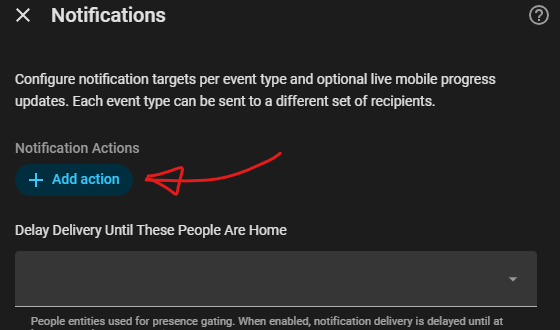

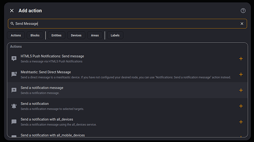

In the notification section of your WashData click "Add action" then type "send message" into the search bar then scroll down to the one that is named "Send a notification message"... that is the notify.send_message action:

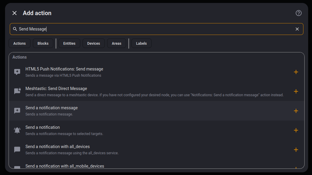

Do you mean here?
I didn't understand when these actions are triggered because I want to trigger only on Cycle Finish, not have a Notification for every state change... But maybe I'm misunderstanding the Notification Actions purpose.
Yes, that was what I was talking about, but I think that will send all the messages... the integration docs are pretty light on explanation for all the notification options.
And, I see what you mean about trying to do it with only selected message types. It looks like you'll have to use the Events until/unless those options are updated to use full Action selectors instead of the service list they are currently using.
