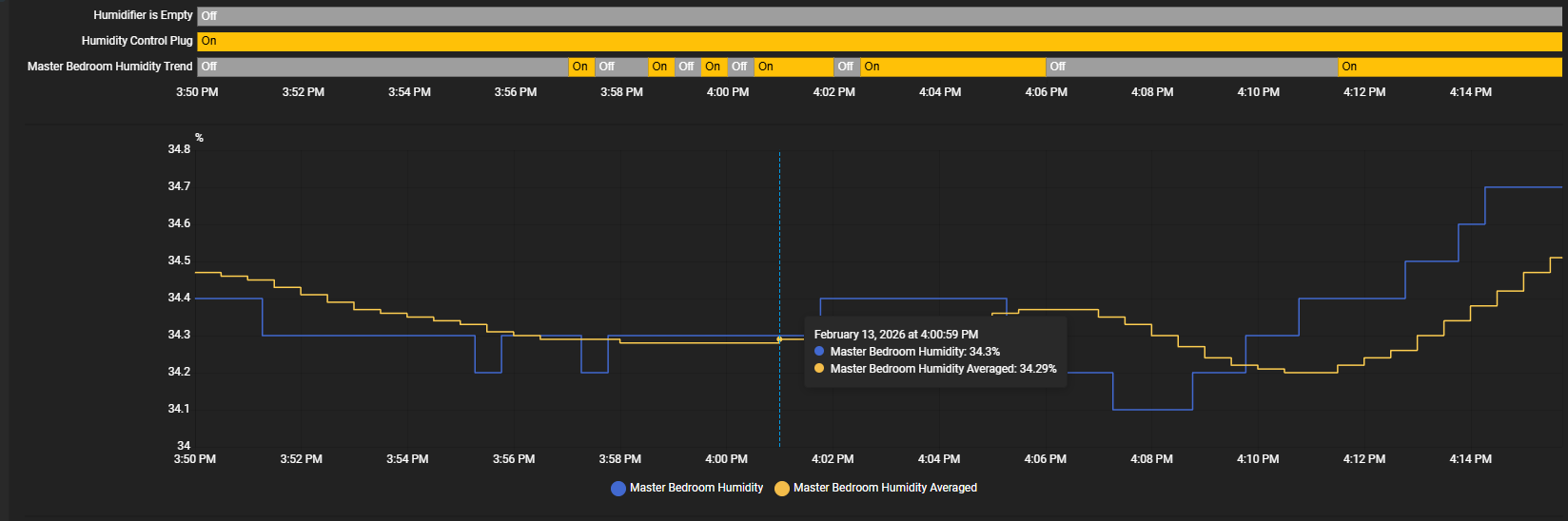

here is the hostory charts for those entities:
the trend sensor isn’t trending the average sensor correctly.
you can see at 3:56 the average sensor is flat but the trend sensor is on
then at 3:57 the average sensor is still flat (no change in value) but the trend sensor turns back off.
then the trend sensor turns off and between 3:58 and 4:01 but the average sensor is totally flat between those same times.
then it does some other funky stuff later as the humidity dips and climbs again after the humidifier is switched back on.

So your trend sensor is on when the average sensor gradient is at or above 0 %RH per second over a sample of 2 state changes. So it should be on whenever your average is increasing in value. Which it mostly appears to be doing.
Your average sensor might have more significant digits in its state than the 2 displayed in your graph, which is causing the changes when the average appears to be flat on the graph.

One way to stop this binary sensor flapping would be to specify a minimum gradient very slightly above 0.
Yeah I agree that’s what it generally does I just don’t know why it oscillates off and on when the sampled sensor flat lines.
I checked the actual sensor value in dev tools and the template editor and it has only 2 digits of precision as displayed in the graph.
unless the graph precision is hiding the actual fluctuations of the sensor even tho it’s only 2 digits of precision? It’s hard to know if that’s the case if the only way to see the history of the sensor is the very graph that’s hiding the actual changes.
