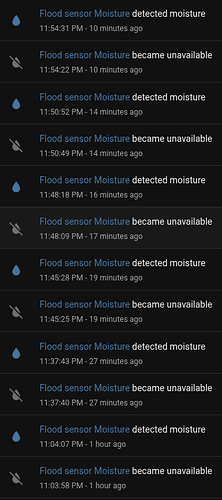

I installed the new Connect ZBT-2 today replacing a Sonoff ZBDongle-E. Migrating my network worked flawlessly and everything seemed to work great.
After a couple of minutes I started to get notifications that some sensors were unavailable. I assumed it was because the network needed to settle. So I gave it a few hours. Hours later they were still dropping out multiple times an hour and immediately reconnecting.
I tried:
  • Waiting for the network to settle (3+ hours)
  • Relocating the antenna but it shows good connection (255)
  • Disabeling my 2.4GHz network
  • Reflashing firmware to previous version 7.5.5.5 (current 7.5.5.6)
  • Changing USB port to the one the Sonoff dongle always used
I never had any issues with the Sonoff dongle. My network works even with the frequent dropouts but all the devices constantly reconnecting puts a lot of pressure on my Zigbee network and I am afraid automatisations will fail to trigger. I use Zigbee for home security so I need it to be reliable.
Any advice is appreciated!

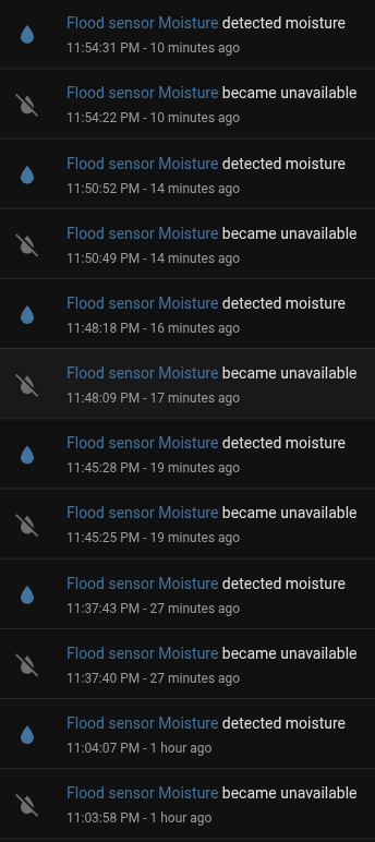

An example:
