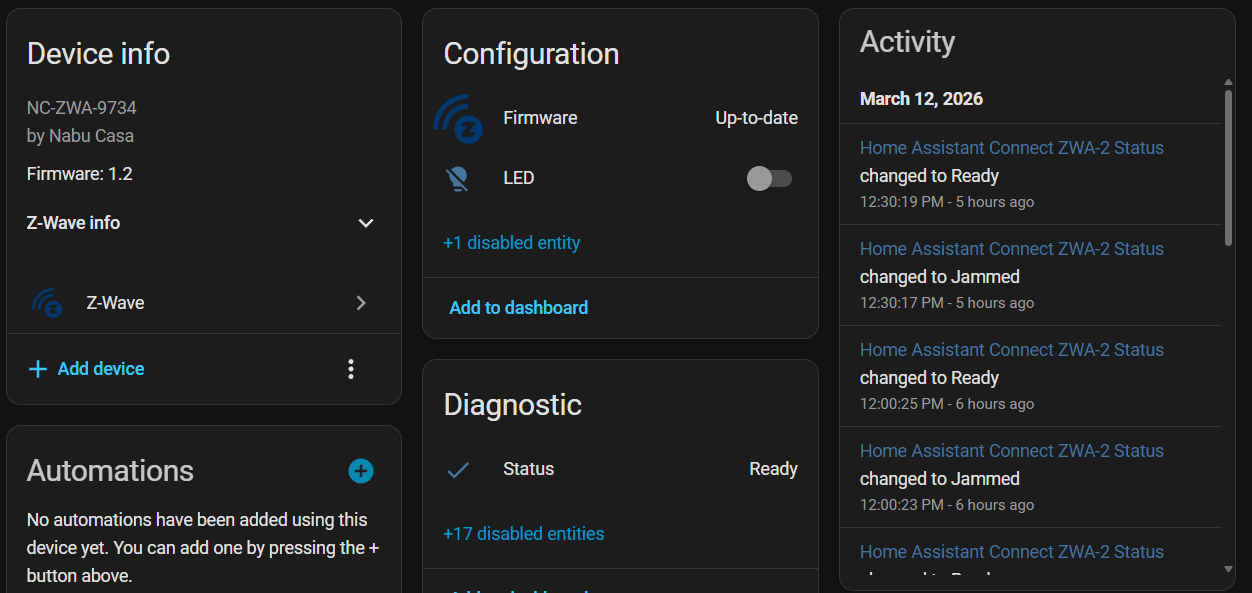

Hi, So my PoE connected ZWA2 show multiple times per day the jammed message. The network has about 130 nodes and it seems to work fine.
I have researched a lot about the subject, canāt find anything conclusive.
Is your ZWA2 doing the same ?
