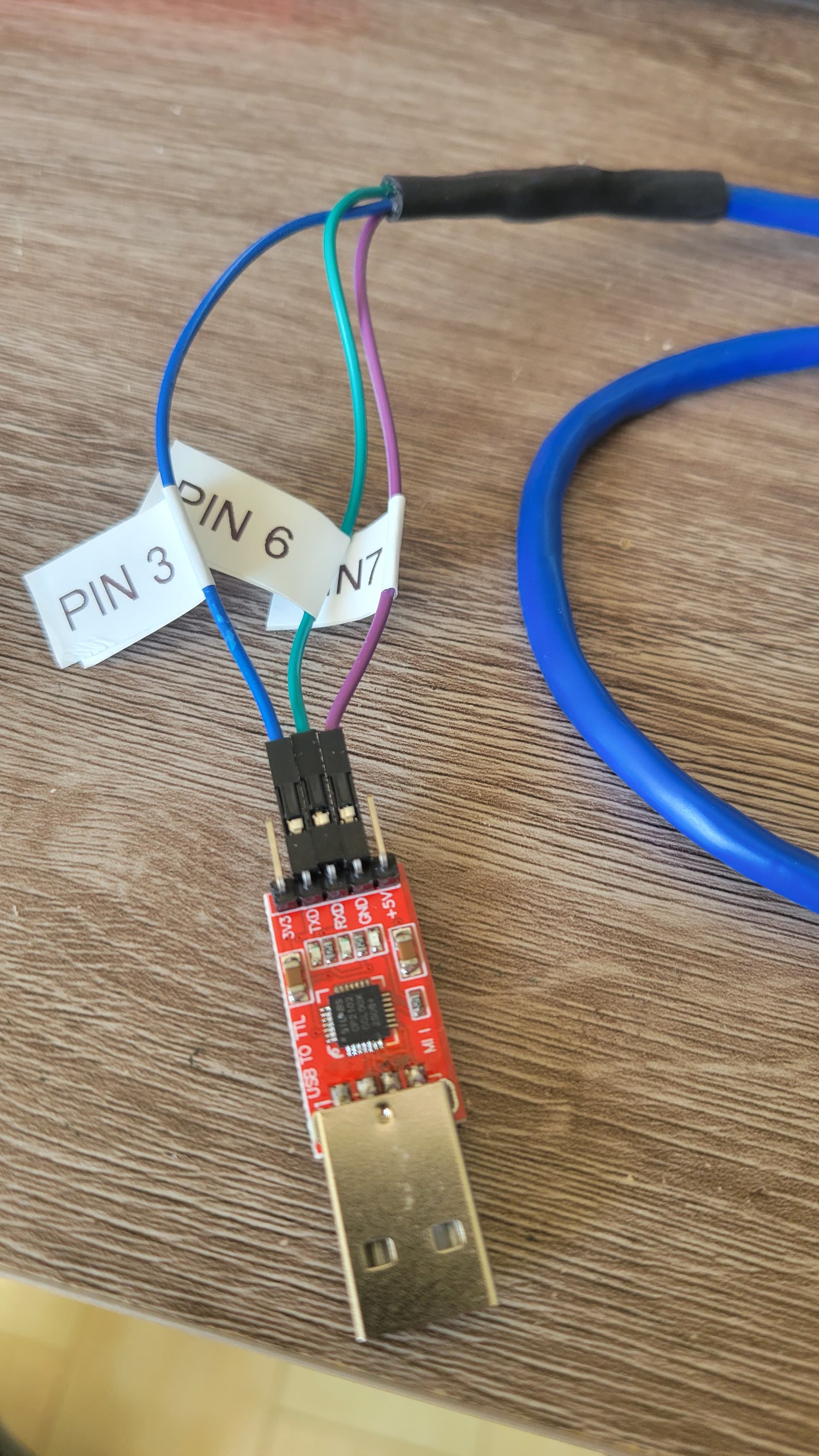

Check your wiring as well, as that is also a gotcha.

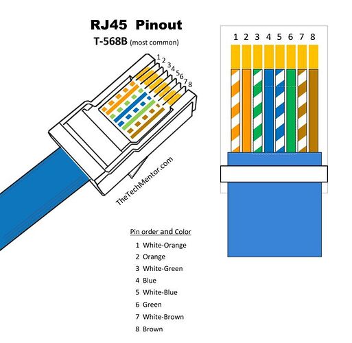

If you can find an adapter that has flashing LEDs onboard that indicate activity, that may help with diagnostics. I have a custom built RS232 to RS232 adapter built with these LEDs specifically for troubleshooting. Careful tracing of your wires is a cheaper solution. Often wiring diagrams show the socket instead of the plug end so your connections are incorrectly mirrored. Some adapters only connect the three most commonly used pins: TX, RX and ground, and others bring out the secondary RI, RTS/CTS, DCD/DTR ones that may be needed for correct handshaking.

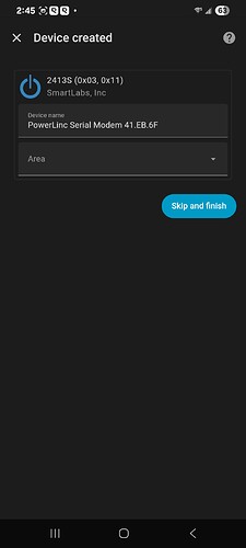

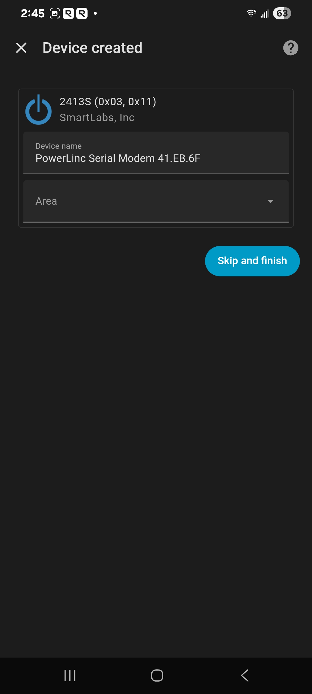

Thank you OldSurferDude your suggestion worked. The cable i purchased most likely has the 2 pins 3 and 6 crossed.
Picked up the PLM quickly. Thank you all, very much appreciated!
