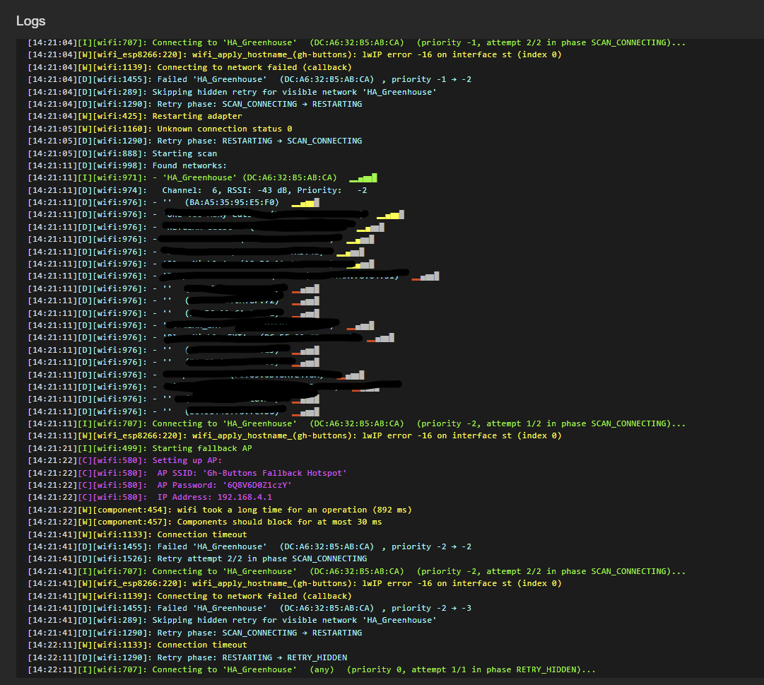

Here are the logs for the D1:

Your log is very hard to read, but it seems to indicate your device can’t connect to your AP.

With everything redacted, the only thing the log says is your device can’t connect to redacted.
It seems like there might be a lot of Wi-Fi activity where it is located.
There is one clue in that there is a reason listed which is auth expired and authentication failed. The first thing to check is that you have the correct passphrase.
What are you using for Wi-Fi? Some APs have issues with esp devices with some configurations.
Bring your ESP Device closer to your access point for testing purposes and see if it connects then. Say an arms’ length.
Is your network correctly set up? 2.4Ghz for the ESP to talk to? Correct gateway, DNS etc configured? SSID matching and password correct? How busy is your network, taking so long to reject connection?

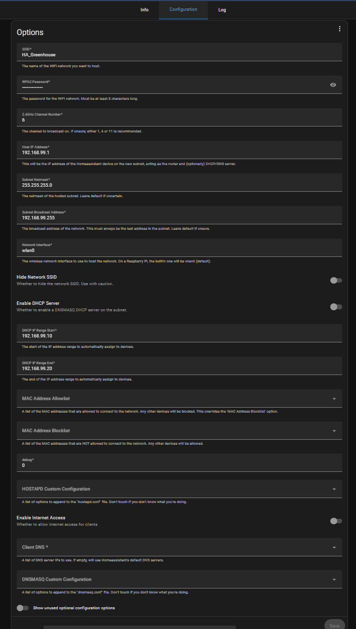

I am using a raspberry pi 4 as the access point. That is the “HA-Greenhouse” network. The “redacted” parts are in the screenshot above.
Currently the devices are about a foot apart sitting on my desk. Here is the config for Hass.io Access point:
I have made sure the SSID and Password match in the secrets.yaml file.
I fixed it. I needed to enable DHCP server on Access Point. Everything is showing online and connected and I am moving forward with the project.
