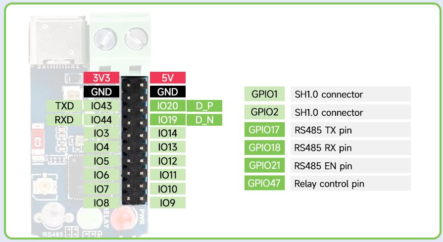

I bought the same device and connected it but I couldn’t find anywhere what pin I have chosen for communication.
Could I please add a yaml file with the configuration to the instructions, it would certainly help others. Thank you very much
I have already found the picture. I am attaching it.
