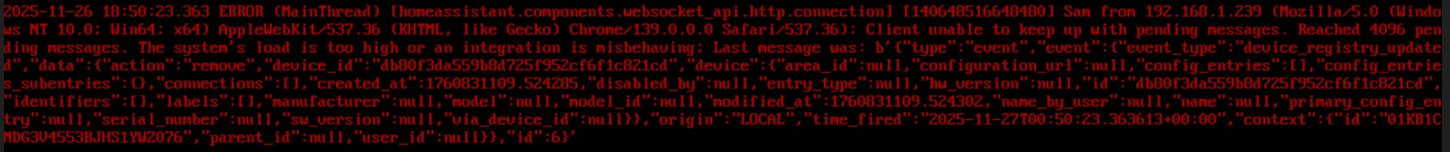

Looking at the core logs through the cli I get this error:
I am guessing an integration is not working correctly but it is difficult to disable them as I have at most one minute after a reboot to do things in the ui.
Does anyone have any ideas for what is causing it? I can try to upload other logs but I thing I am limited to the cli interface I can get from unraid.

Thanks for the response. I have tried safe mode and it still loses connection after one minute. Would this indicate an issue with my network instead of home assistant?
It could be, or the hardware or maybe in rare cases HA core.
I say rare cases, because I have not seen a lot of other users having issues on the forum.
The safe mode just rules out third party integrations.
