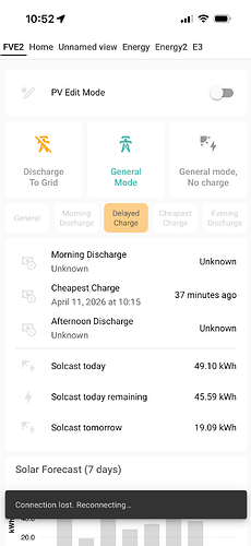

Connection lost......reconnecting. Frequently
Unfortunately, suddenly starting from today, I experience the same.
I can’t start the HA anymore, it hangs on Connection Lost. Reconnecting…
I can’t get in the system anymore, dashboards are not loaded, I can’t do a safe restart, it simply got stuck, and remains stuck, also after switching off the power of the computer (HA Green)
Anybody a suggestion on how to get in the system again?
Frequent issue for me. used to just work but since update to 25.12 i loose connection and have to wait for 30 sec for it to come back, or a forced refresh.

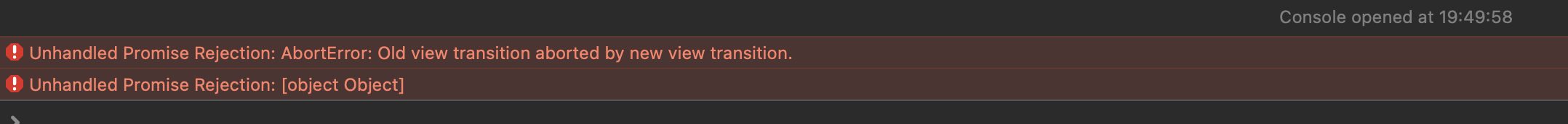

this is what my inspector shows
