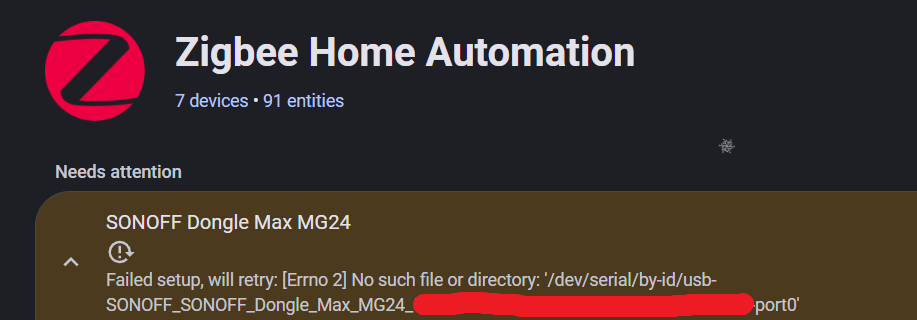

The Zigbee network goes down every few hours or every time I restart the PC/VM. When I look into HA, I find something like this:
(I blurred some kind of device ID. I didn’t know if this was supposed to be private or not, but just to be sure :smile:)
I figured out that whenever this happens, one of these issues appears:

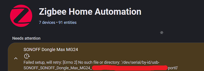

  2. The dongle doesn’t change its name and just becomes unchecked in enabled devices. Trying to re-enable it causes this error:
The only way I found to fix this is to physically reconnect the dongle, and sometimes restarting the VM as well.
