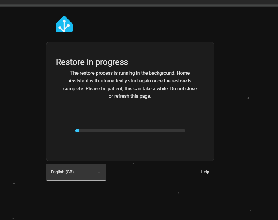

Restore is underway, had to find my encryption key, that was fun :smiley:
wrong vlan, ip addresses are wrong, god knows how this will start back up :frowning:

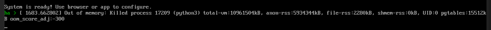

The HAOS console showed repeated OOM killer events affecting both Music Assistant (mass) and Home Assistant Core (python3). One of the Core events was:
text Out of memory: Killed process 3428352 (python3) total-vm:6845188kB anon-rss:4079676kB file-rss:5220kB shmem-rss:0kB UID:0 pgtables:10008kB oom_score_adj:-300
I initially stopped the Music Assistant add-on to rule it out. This temporarily freed resources, but Core was killed by the OOM killer again after being started, so Music Assistant was not the sole cause.
The Core CLI command itself completed successfully:
text ha core start Processing… Done. Command completed successfully.
However, the python3 Core process was killed by the kernel shortly afterwards. The watchdog then attempted to restart it, causing the loop.
