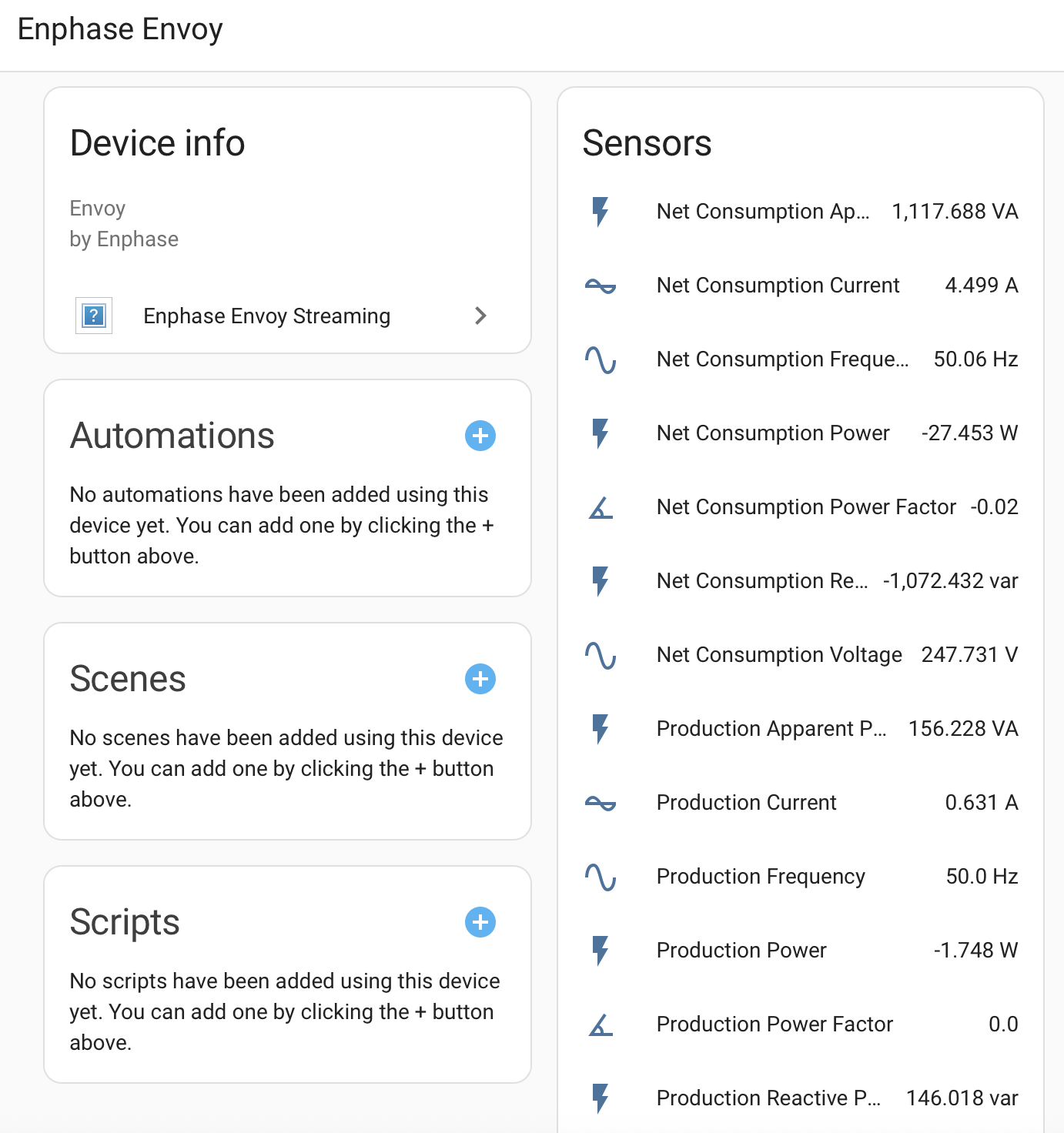

I managed to vibe code an integration for streaming the data from the Envoy using Claude Code. Took about 3-4 hours in total fiddling around with it. I know nothing about writing anything for home assistant, yet here we are…! :slight_smile: It really does update every 1s or more!
I’ll try and get this into HACS if/when time permits. It’s totally barebones alpha quality but the point is it works. It uses the httpx library to maintain the streaming connection. You need to use digest auth, and you need the installer password.
