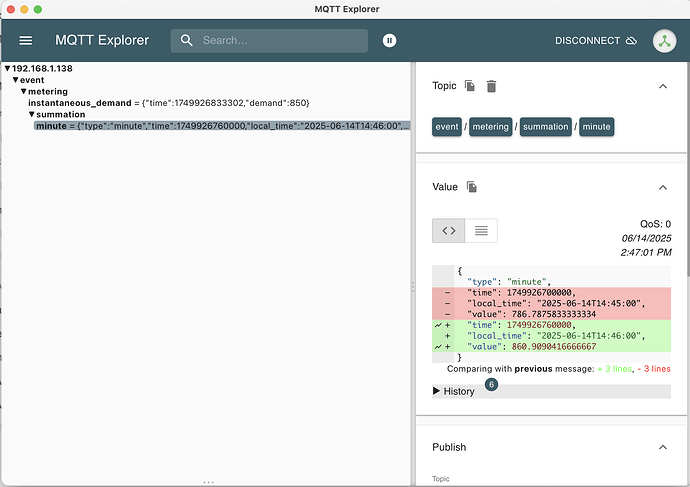

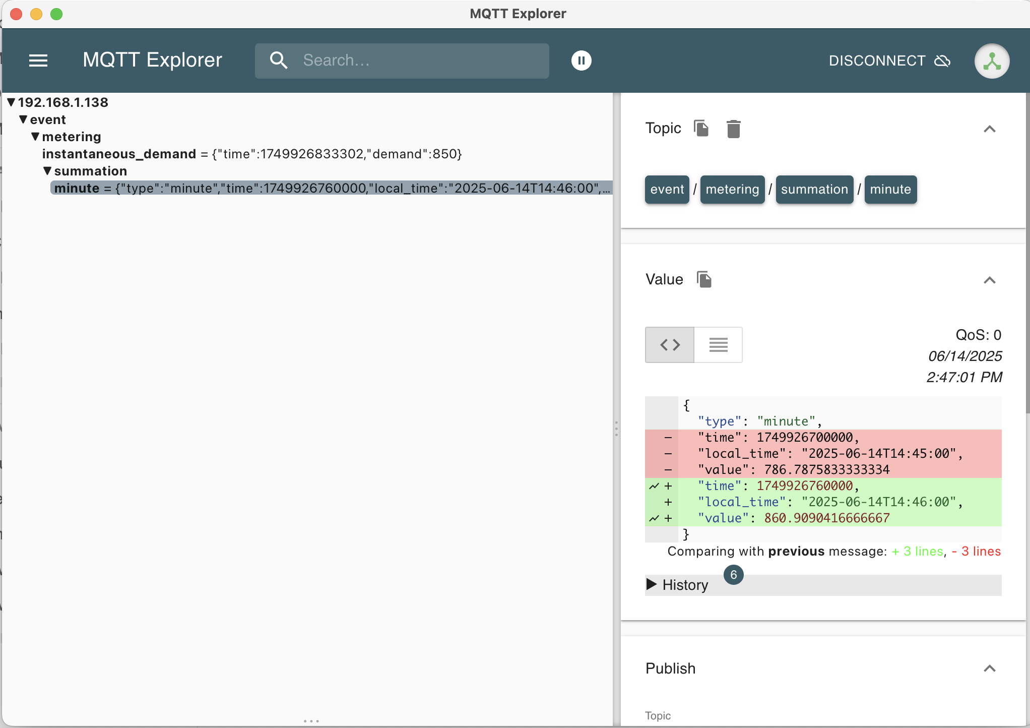

I used mqqt explorer to connect to port 2883.
mqqt://???.???.???.???:2883
