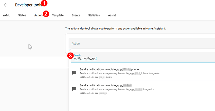

I have notifications going to my iPhone in other ways, but can’t find an appropriate entity in HASS that starts with “notify.” that the blueprint seems to want.
How do I find the correct entity?
Thought it was just this:
That’s what I needed. thanks.
