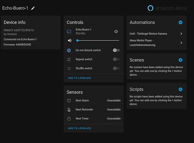

There is a custom component to include alexa devices as media_player within HA:
this is how it looks like:
Using this component you are able to control the volume via service media_player.volume_set / media_player.volume_up / media_player.volume_down

This works great! One interesting thing with media_player.volume_set: its in intervals of 0 to 1, so 30% for example would be 0.3.
