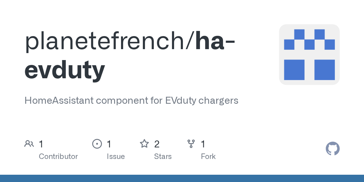

I can also simply control the EV charger through the app, but I was searching for a way to control it via home assistant. Since it’s made in Quebec, mainly for Quebec, there may not be a big enough market for it and I can’t find an integration.
All I find is this github that seems to only have python code and… apache license info.
I have no clue what it can do or how to use it. Others I have found gave you a repository link to side load, but this one has no instructions.
Anybody used it? Or know how I could try to add it and see what it does?
Thanks
TL;DR: got an evduty EVC30 EV charger, it can connect to an app with wifi to be controlled, but I’d rather skip the app and control it with Home Assistant. Is there anything to do with the linked github?
Update: i found how to create the custom component, but the code is apprently broken and uses a deprecated API (Evduty-free vs Evduty-api). Tried fixing it with Claude.AI as I have no clue how to update it and after trying a few things it just told me it can’t be fixed without a lot of work.
