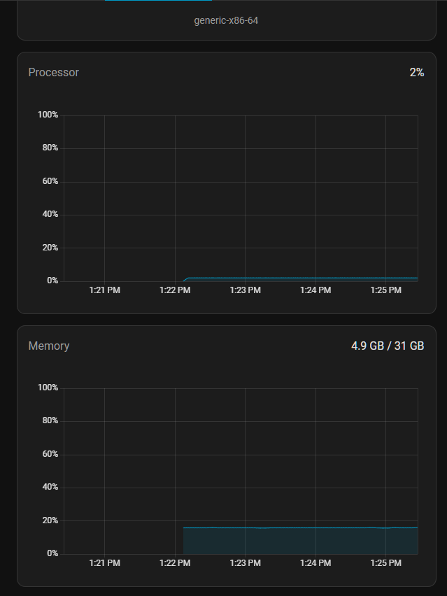

I run HA on a dedicated computer running a Core i7-11700K with 32GB of memory. That is all the computer does
This is my normal load

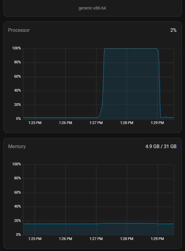

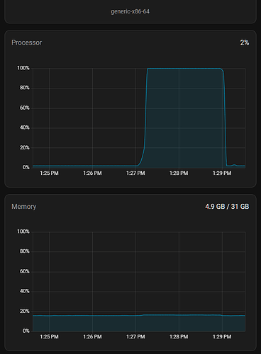

This is what happens when I start the add-on let it run for a little then stop it.

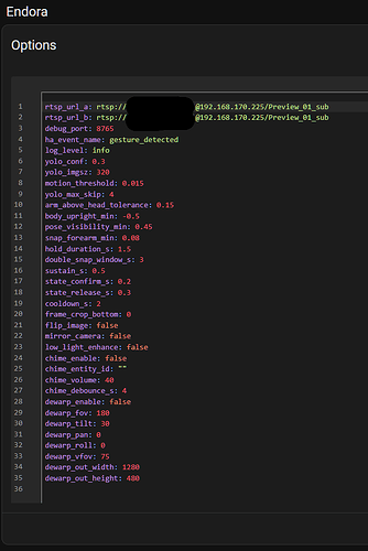

This is the config I am using

The CPU will tend to be very high - it will use as much as it can to get as high a frame rate as possible. That said, on my RP, it has not noticeably affected load average, just CPU (I have four processors on my RP5, and my CPU is at ~300% or so. The rest of HAAS does not seem to register any slowdowns.
I added a 480 model to go with the 320 and 640. It can be selected in the App Configuration page as yolo_imgsz. With 480, my CPU dropped to ~300%. With 320 it will drop to ~200%.
I will test it more. It does seem though that yes even with it reporting 100% CPU it does not seem to effect the speed of anything else.
