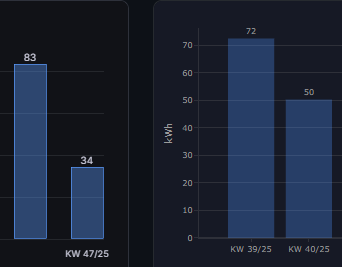

I have card-background-color correctly set in my style file, and plotly-graph card (and all others) are showing it correct, but the iframe card with a transparent Grafana is not showing this card-background-color.
On the left side is Grafana, on the right side is Plotly-Graph.
So if it’s not possible to overrule an iframe card background, I will stop searching for a solution and leave it as it is, it’s not a big problem.
