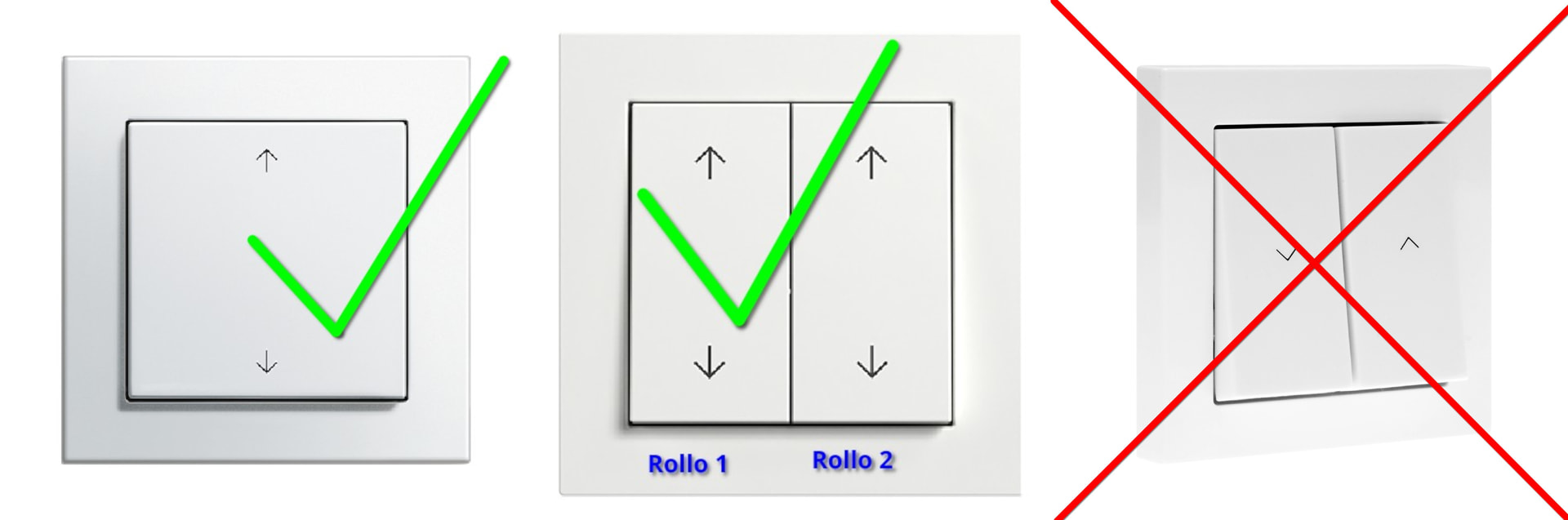

  • Control via a single rocker switch per blind (up/neutral/down; which always returns to the neutral position when released), so that I can, for example, use a single double rocker switch for two roller shutters (to save space). See pictures.
  • The rocker switch should be wired and always work reliably as long as there’s power, regardless of Home Assistant, the network, Wi-Fi, etc.

I’m using Sonoff MINI-ZBRBS for my exterior blinds. There is a switch input S1/S2 for button output up/down. The modules are tiny and fit into the junction box behind the switch. It uses zigbee protocol. I’m very happy with them.
To make it work in HA, you’ll need a zigbee coordinator and install mosquito mqtt and zigbee2mqtt. After you pair and calibrate them, you’ll be able to see and set the position of the shutters. You can set up an automation to alert you if the device fails.
You didn’t say if you’re in Europe or the USA or wherever. Standard European junction boxes are pretty small and you probably won’t be able to fit 2 modules behind a double switch. If in the US, make sure your electrician puts a double gang box if you plan on a double switch so 2 modules will fit.
That’s going to depend on the switch itself. The switch isn’t smart, the relay is. So you’ll have to find a switch that operates the way you want. Most of them will go to the limit if you hold one direction for a few seconds or double press them. Some have a stop button, and when you press one direction it will travel to the limit or stop only when you press stop.
