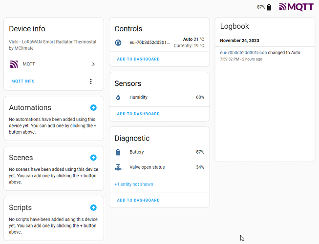

Only available automation action is:
I am searching for a MQTT solution where I can change the the “targetTemperature” in automation, I don’t use the HVAC mode because the intelligence is already inside the device and need only to change the temperature.
Found a slution to add a “mqtt number” as extra to the device which made it possible to control te targetTemperature through automation:

Hi FreddyS96, I don’t know if you are still interested, but I have created a new Node Red flow which has many improvements and is also usable for other LoraWAN device.
The config looks more complex but is far more straight forward to Home Assistant:
And here the result for the Vicki:
