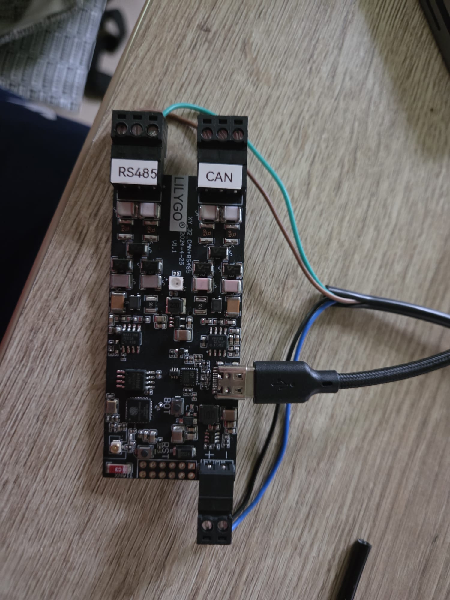

Hi Jurgen,
It’s this board T-CAN485 – LILYGO®
and this repo works well Controlling a Fairland Pool Heatpump eliminating Tuya - #38 by Elwell
