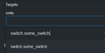

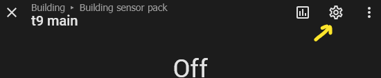

On the overview page click on the switch so that the more info popup comes up. Then click the gear icon on the top right. There you will see the entity id of the switch. copy it.
Go to nodered and enter the entity id in an action node and select it.
Select switch.turn_on in the action section.
Thanks. It works!
