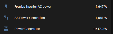

I have power from the inverter and from solar analytics which is delayed:
sometimes one or the other is not available so I have an item Power Generation which takes the first value and if it's not available takes the 2nd value.

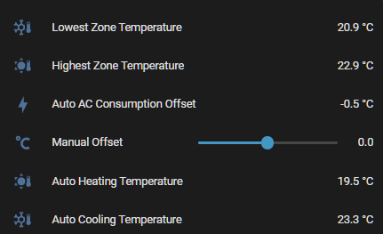

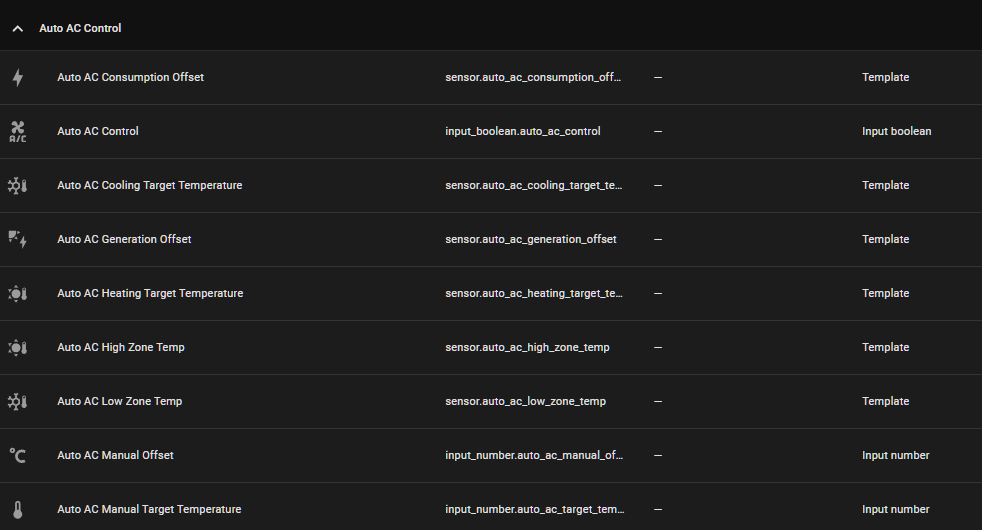

I have some helpers to run everything
To help me find hottest and coolest zone in summer and winter for example

Auto AC Manual Offset
this is just a number on my dashboard I can quickly adjust the overall temp
Auto AC Manual Target Temperature
this is a number on the dashboard that I want for my target temperature for that day. I change it using a scheduler
For example in summer I set the lowest temperature I would want

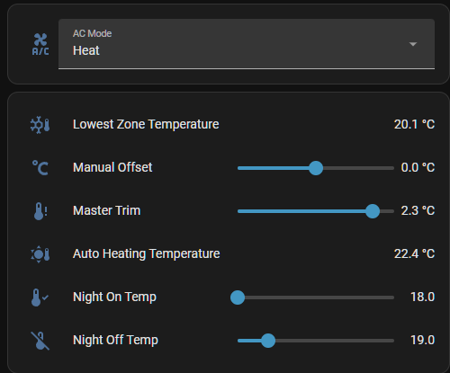

Dashboard
now I have target temperature based All the variables I've factored in

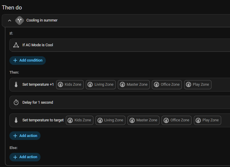

I have an automation "Auto AC Control" that checks every minute and sets the air temp if it's not already set
airtouch does not like small changes in temperature so I have to one degree away And then set it back.

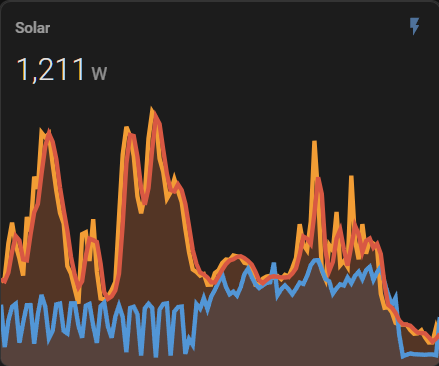

the result is that my usage in blue tries to stay below generation in orange
that's the best I've been able to do but because I don't actually know the power usage of the it's a bit of a guess

now there are two bits of code changing temperature adjustment I will have to test a bit to see how it works

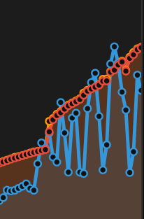

I think because the air con is delayed action When I set a temperature it takes a while for the air con to ramp up and achieve whatever power it's using.
so it seems to keep going up and then exceeds the solar available and then it set down, and keeps bouncing like this because of the lag between setting temperature and the effect becoming apparent on the electricity report...
I can see that the trim is kind of Mirroring the consumption, but the consumption is delayed by two or three minutes possibly
