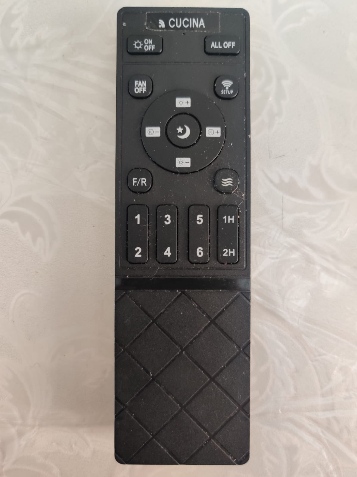

I need to check if my fan lamp is BLE compatible. The included remote is shown in the photo. I have the integration installed and esp32-ble-proxy and one fan lamp works perfectly with the remote_v3 protocol, but other four lamps use different remotes (identical as the one pictured) that don’t work with any app - only their physical remotes. Duplicating remotes doesn’t work either. Are these BLE compatible remotes and lamps? Am I doing something wrong or are these devices incompatible?
external_components:
  - source: github://NicoIIT/esphome-components@main
    components: [ble_adv_controller, ble_adv_handler]
This doesn’t wompile anymore in recent ESPHome version.
I saw on other external componens pages that a recent version (2025.7 ?)broke something, but i didn’t understand what exactly.
