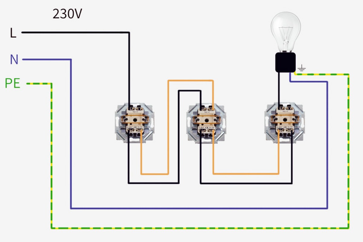

I’ve got a dumb light in the hallway that is currently controlled by three dumb switches. I checked the switches and they are currently wired in a configuration like this (two normal switches, one cross switch):

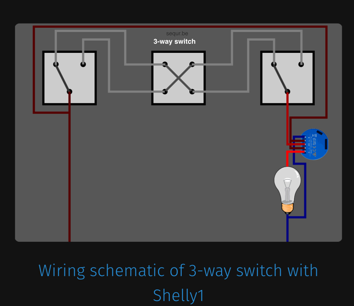

Should be similar to this wiring, you just need another live wire cable to the relay
Yes, I concur with this recommendation. You only need to place one new device and you have a fallback option that works even if your network goes down for whatever reason.
There’s plenty of options for the relay, Shelly will work bit also Sonoff, Nodon etc
