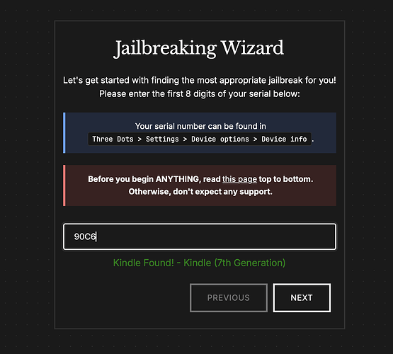

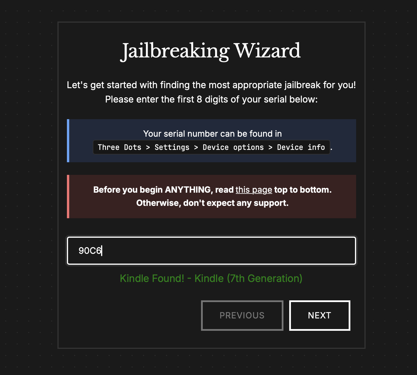

  1. Pick the right jailbreak using the wizard. In my case it turned out to be WinterBreak2.

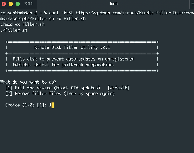

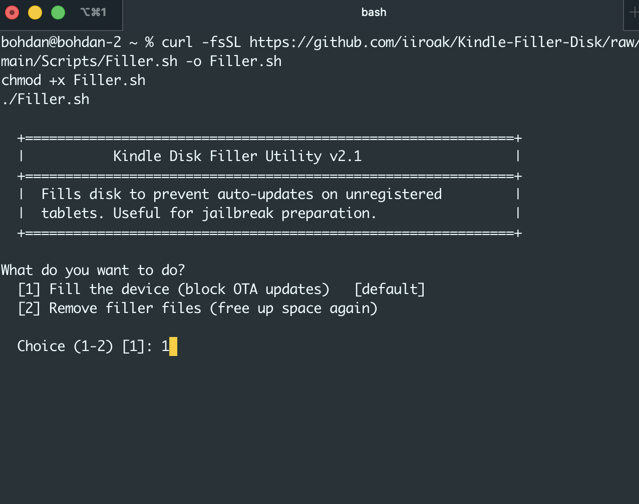

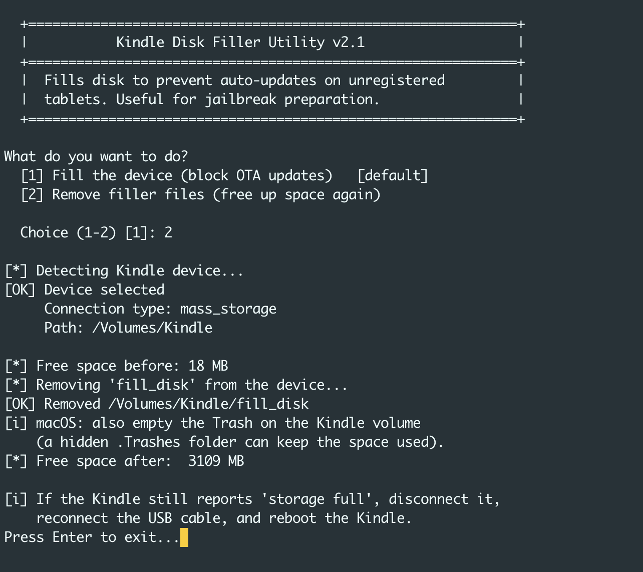

  1. Fill up the device storage so it can’t update itself. This is where I hit a snag — the script wouldn’t accept my answers in the browser. So I downloaded it first and ran it locally instead.

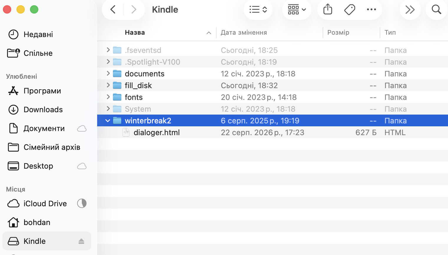

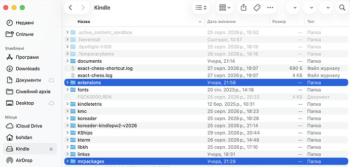

  2. Unpack wb2.zip and move the winterbreak2 folder to the root of the Kindle.

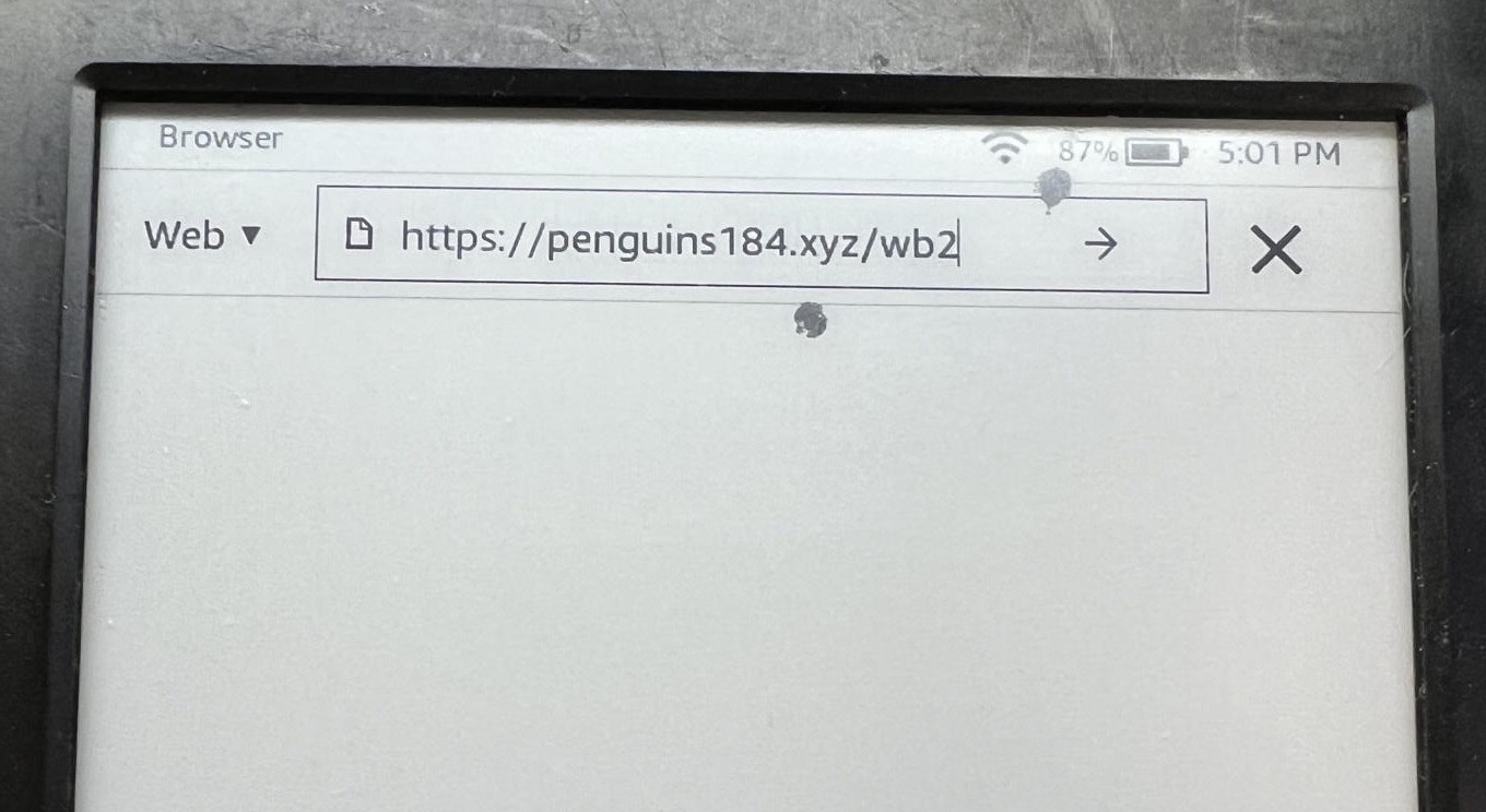

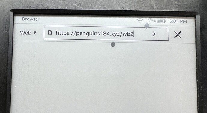

  2. Open the Experimental Browser and go to https://penguins184.xyz/wb2

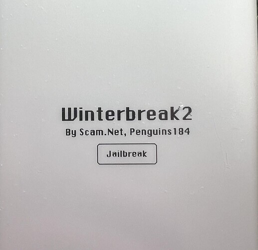

  1. Press the Jailbreak button in the middle of the screen.

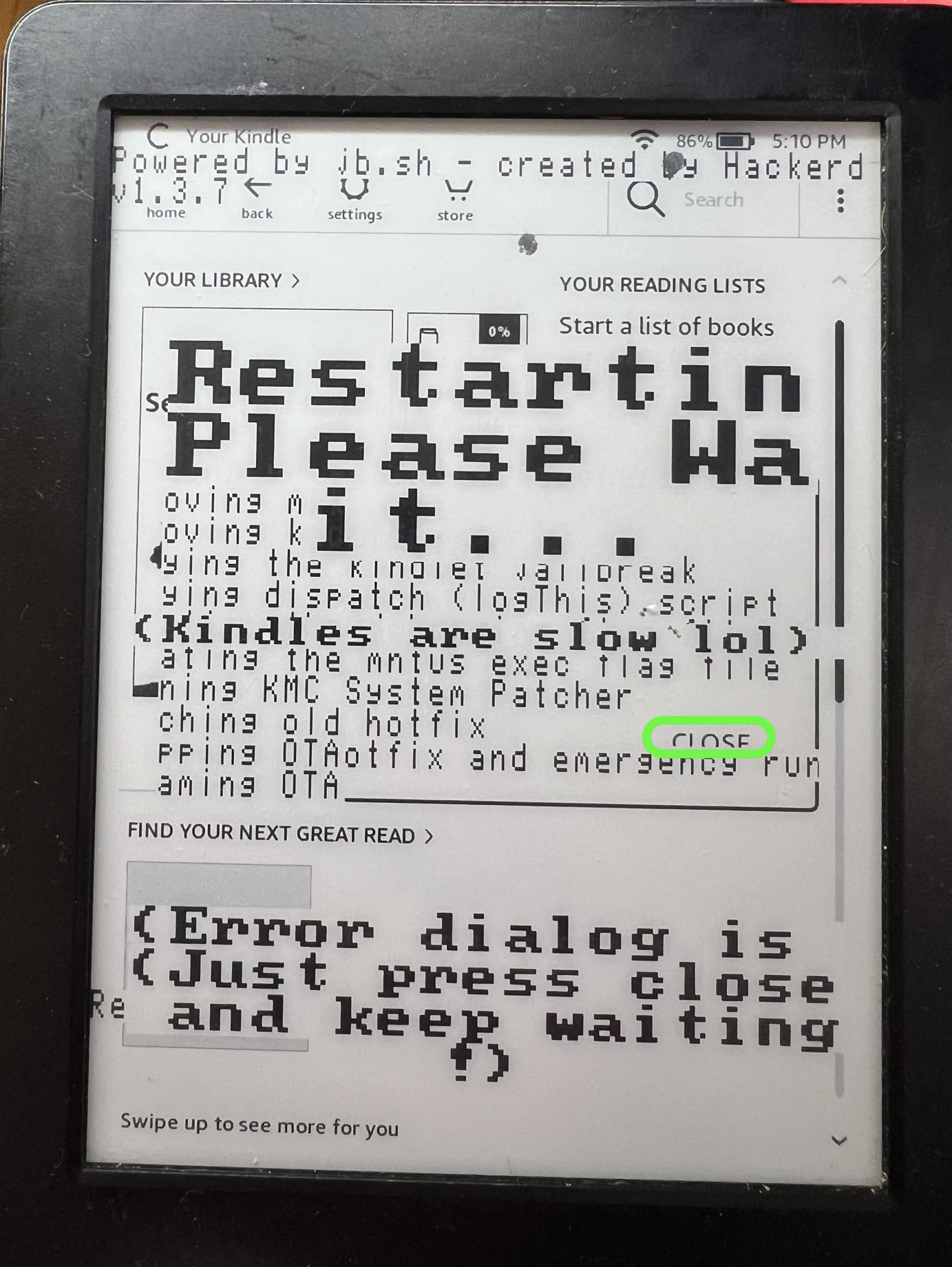

  2. The process starts and a strange-looking window appears. Don’t panic. After a moment a not-very-obvious Close button shows up in the bottom right corner — tap it. To check whether the jailbreak worked, type ;log into the search bar. In my case a new text file named JAILBROKEN appeared. That means you’re in.

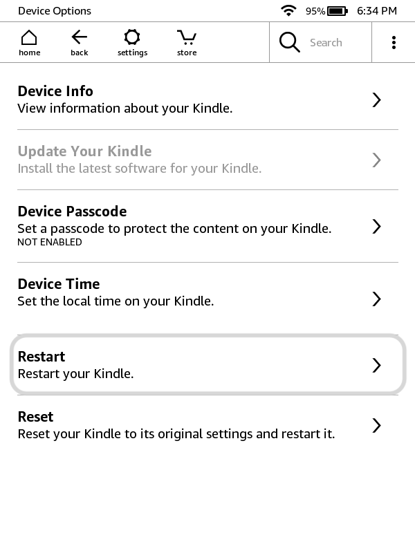

  1. Reboot the Kindle: three dots → Settings → Device Options → Restart. Wait for the reboot to finish completely.

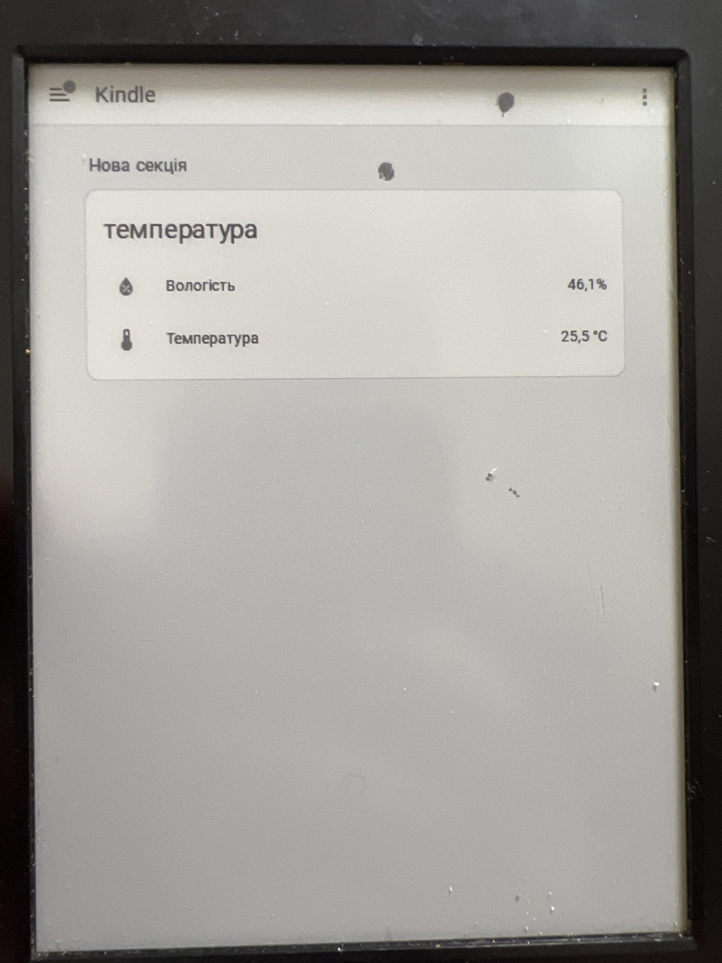

For the interactive dashboard I used the Kindle-Home-Assistant-Remote project by derekmcauley7 as a starting point.
In short: you create an HTML file with the controls in it, put it inside the Home Assistant file system, and open that file in the Kindle browser.

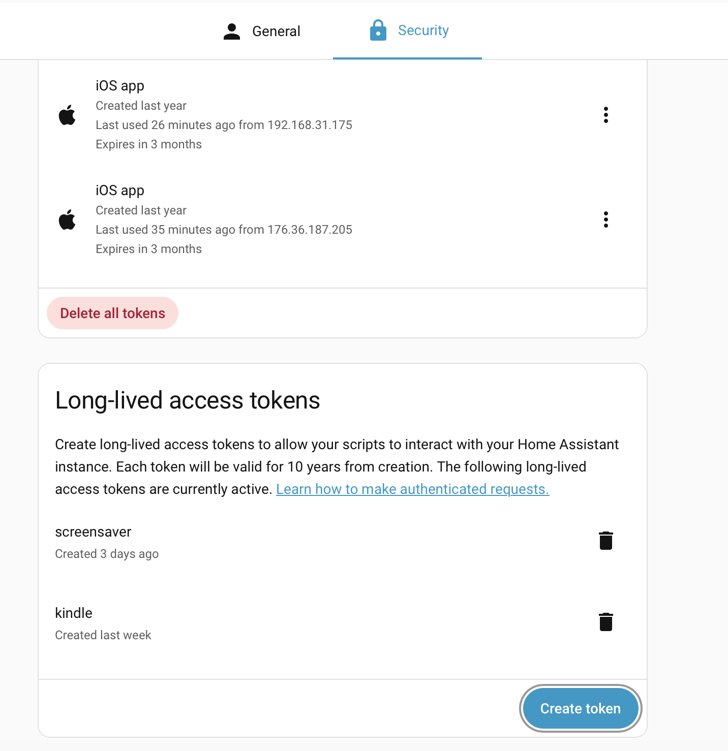

  1. Get a long-lived access token in Home Assistant. Sidebar → your user profile → Security tab → Long-lived access tokens → Create token. Give it any name and copy the token.

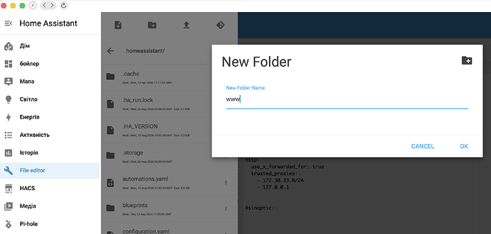

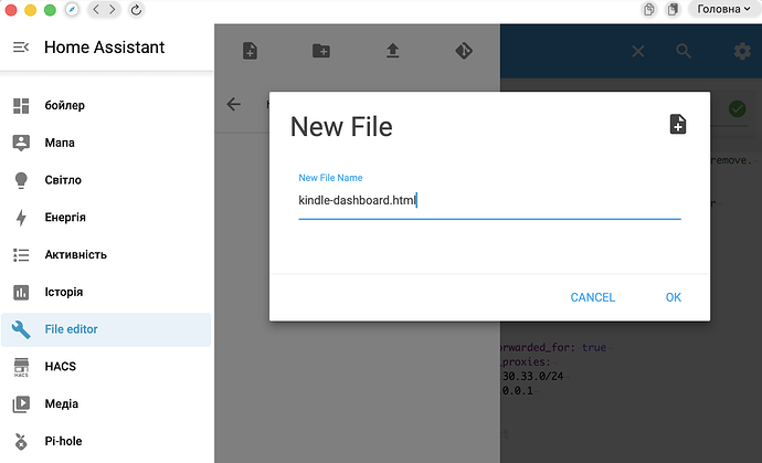

  1. Using the File Editor add-on, create a folder called www. It must sit at the same level as configuration.yaml. If you don’t have File Editor, install it from the add-on store.

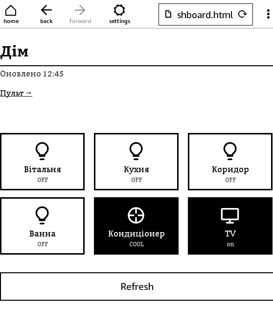

  1. Inside www, create an .html file with any name — for example kindle-dashboard.html — and paste in the code. Here’s my own variation of the same dashboard: I translated the comments and the interface into Ukrainian, and added tiles, behaviour and domains for a TV and an air conditioner.
At first glance the file looks big and complicated, but once the structure clicks it’s much simpler. Roughly, it breaks down into a few parts:

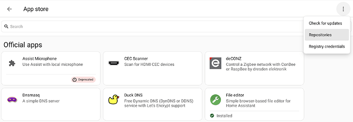

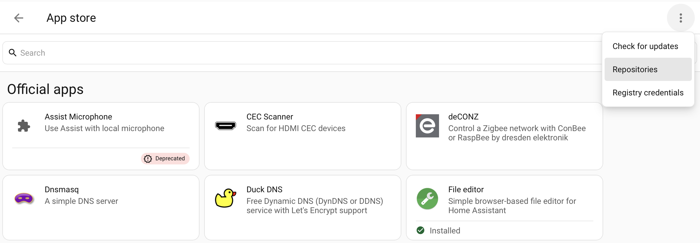

  1. In Home Assistant go to Settings → Add-ons → Add-on Store, click the three dots in the top right → Repositories → Add, and paste: https://github.com/sibbl/hass-lovelace-kindle-screensaver

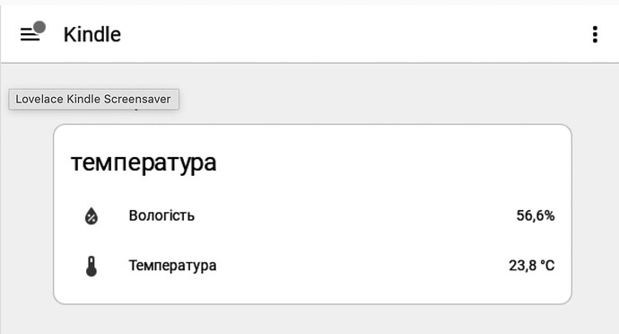

  1. Find and install Lovelace Kindle Screensaver in the add-on store. To configure it you’ll need a dashboard path and a token:
  • Pick an existing dashboard or create a new one and copy its address. For example, the URL I see in my browser is http://192.168.31.172:8123/dashboard-kindle/0, so my dashboard path is dashboard-kindle/0
  • Create a long-lived access token

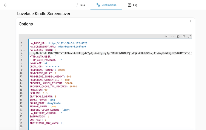

  1. In the Lovelace Kindle Screensaver Configuration tab, enter your Home Assistant address, the dashboard path and the access token. Everything else can stay as it is. Don’t share your access token publicly. Start the add-on.
HA_BASE_URL: http://192.168.31.172:8123
HA_SCREENSHOT_URL: /dashboard-kindle/0
HA_ACCESS_TOKEN: >- 'TOKEN'
HTTP_AUTH_USER: ''
HTTP_AUTH_PASSWORD: ''
LANGUAGE: uk
CRON_JOB: '* * * * *'
RENDERING_TIMEOUT: 60000
RENDERING_DELAY: 0
RENDERING_SCREEN_HEIGHT: 600
RENDERING_SCREEN_WIDTH: 800
BROWSER_LAUNCH_TIMEOUT: 30000
BROWSER_CACHE_TTL_SECONDS: 86400
ROTATION: 90
SCALING: 1.3
GRAYSCALE_DEPTH: 8
IMAGE_FORMAT: png
COLOR_MODE: GrayScale
REMOVE_GAMMA: true
PREFERS_COLOR_SCHEME: light
HA_BATTERY_WEBHOOK: ''
SATURATION: 1
CONTRAST: 1
ADDITIONAL_ENV_VARS: []
  1. If it started correctly, clicking Open Web UI shows a black-and-white image. The same image should be available at your Home Assistant address on port 5000 — in my case http://192.168.31.172:5000

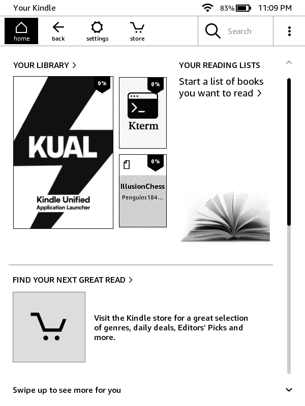

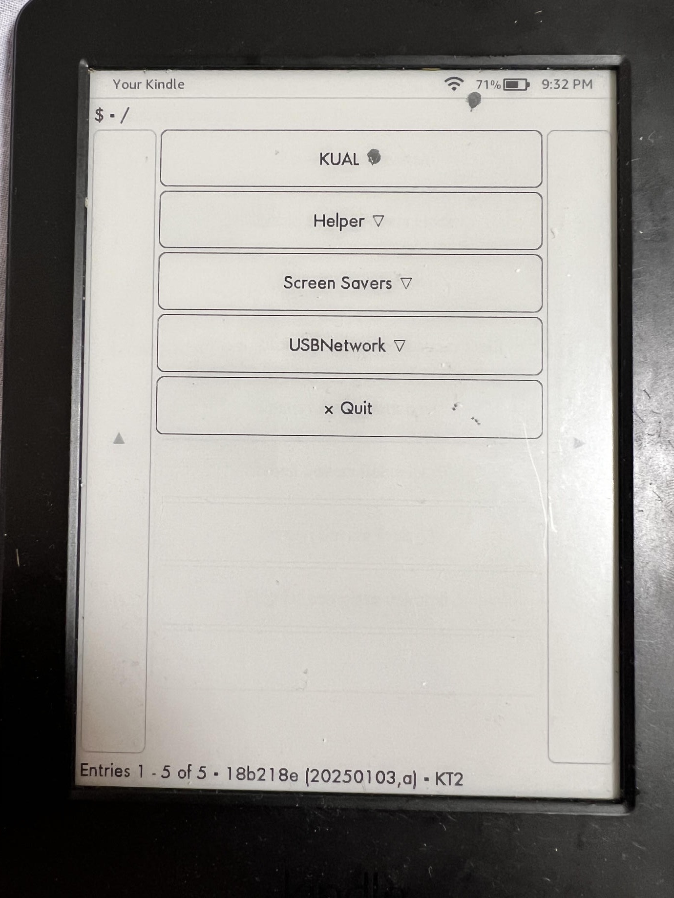

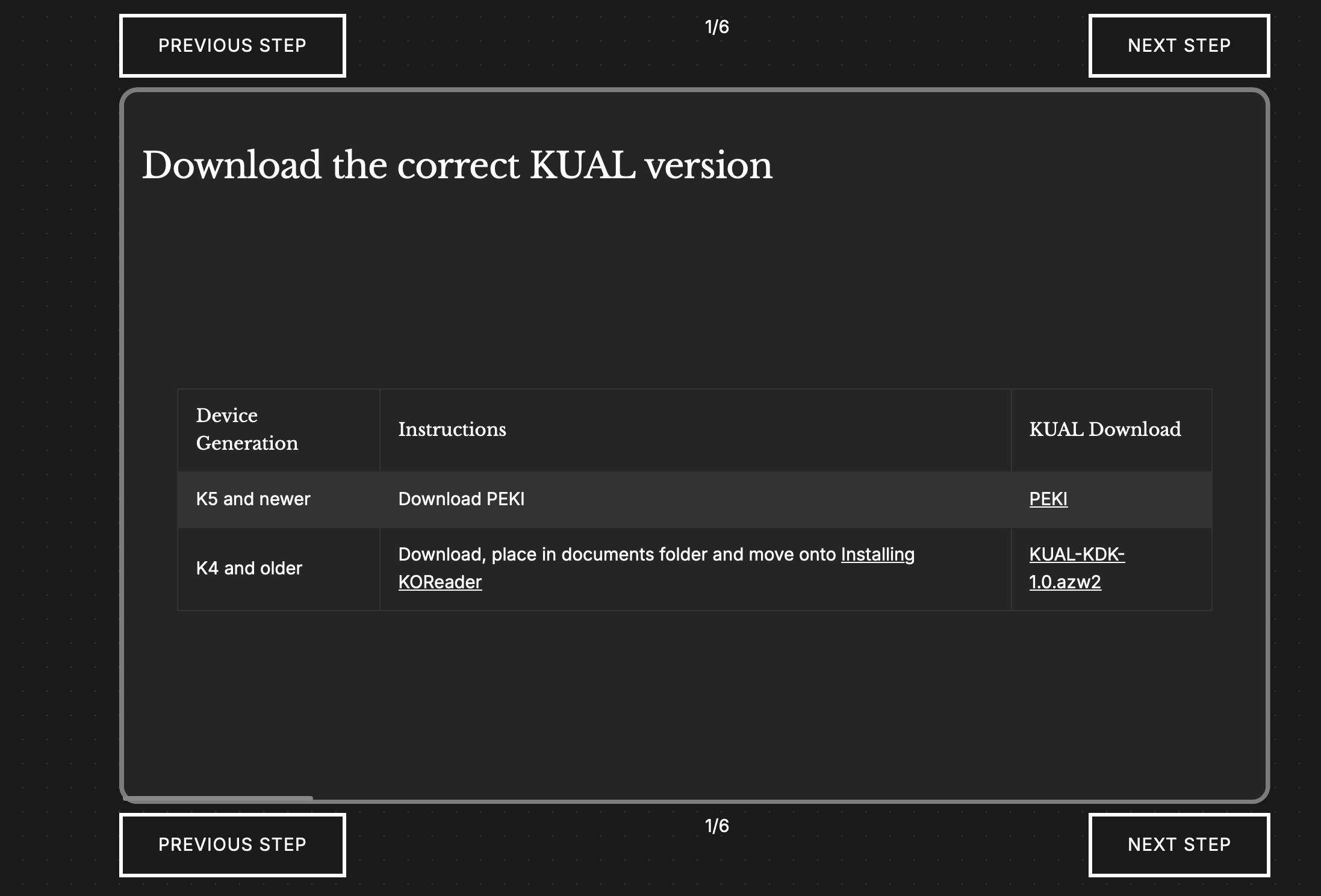

  1. Now install the software on the Kindle itself. First you need KUAL — the Kindle Unified Application Launcher. It’s a menu for third-party applications that the Kindle doesn’t ship with. There’s a separate guide for it on the Kindle Modding wiki.
For my Kindle the first option, PEKI, is the right one, so that’s what I downloaded. Next I downloaded MRPI (MobileRead Package Installer) for Modern Devices.
  • Unpack kual-mrinstaller-khf, copy the extensions and mrpackages folders and move them to the root of the Kindle.
  • Unpack PEKI.
  • Copy KUAL.sh and KUAL.jar into the documents folder on the Kindle.
  • Eject the Kindle. The KUAL icon will appear on the screen.

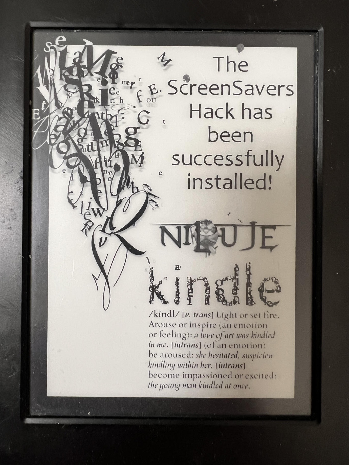

To check whether image replacement works, just lock the screen — you should see a little penguin.
After installation, a linkss/screensavers folder with bg_ss00.png appears in the Kindle root — that file is now what drives the lock screen. Replace it with your own picture: a grayscale PNG, 600×800, with the same filename. There are good ready-made images out there, and it’s easy enough to prepare your own in an image editor.

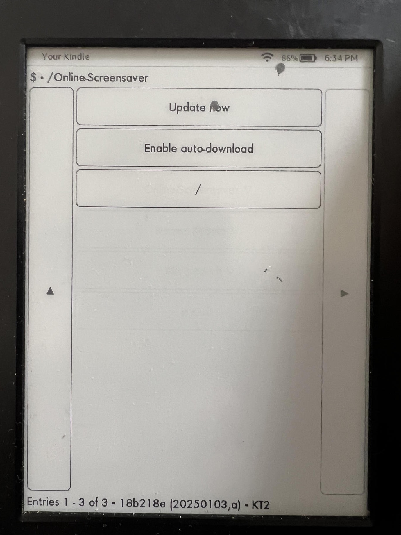

Time to test. A new Online-Screensaver entry has appeared in KUAL. Start with Update now for a one-off download, then put the Kindle to sleep with the power button — instead of the penguin you should see your dashboard. If that worked, choose Enable auto-download; from then on the image updates itself on schedule and survives reboots.
