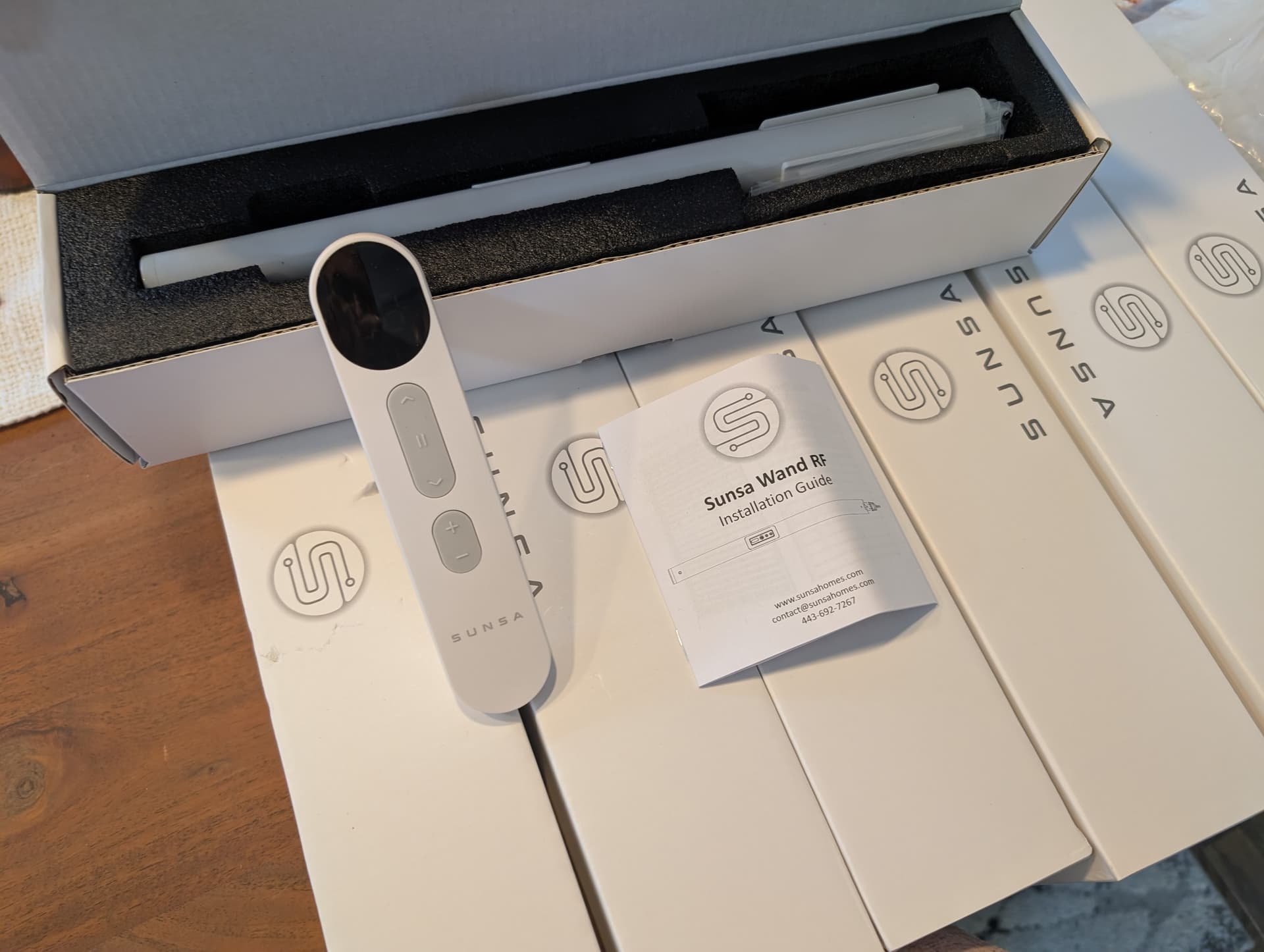

For the longest time I have begged Sunsa to give us local API access to control their first gen WiFi powered Wands, and it felt like my requests were falling on deaf ears. Well, to my surprise, Sunsa did something else, it is a move in the right direction which is them releasing the Gen 2 wand which ditches Wifi altogether for an old school RF radio with 15 channels.
I couldn’t help myself and I bit the bullet and bought an 8-pack as I at least have the confidence that if Sunsa were to seize existing tomorrow, and my Wifi wands stop working as they won’t be able to phone their cloud API, I at least have these local RF-only wands to replace them with.
I finally got around installing one just to test and it worked quite well. They did a very good job streamlining the setup process. There’s an Admin and User mode and a Channel 00 which allows you to control all channels at once.
