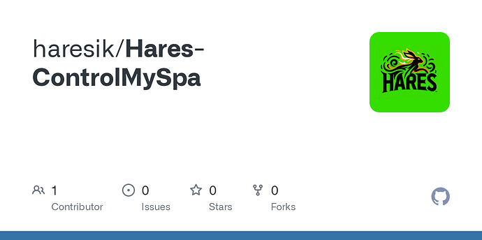

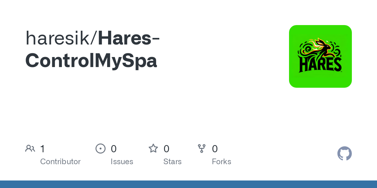

FYI, @hares has now begun working on an experimental native ControlMySpa integration as a custom component (based on the above mentioned library) → GitHub - haresik/Hares-ControlMySpa
many thanks to @hares installed and working well! Now if balboa would just fix the dhcp issue so it would stay connected!
