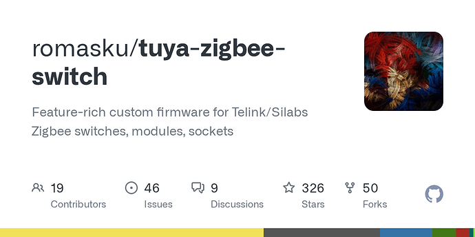

Another option is these tuya switches that you can flash with custom firmware via ota (enable binding, router mode, long press)
