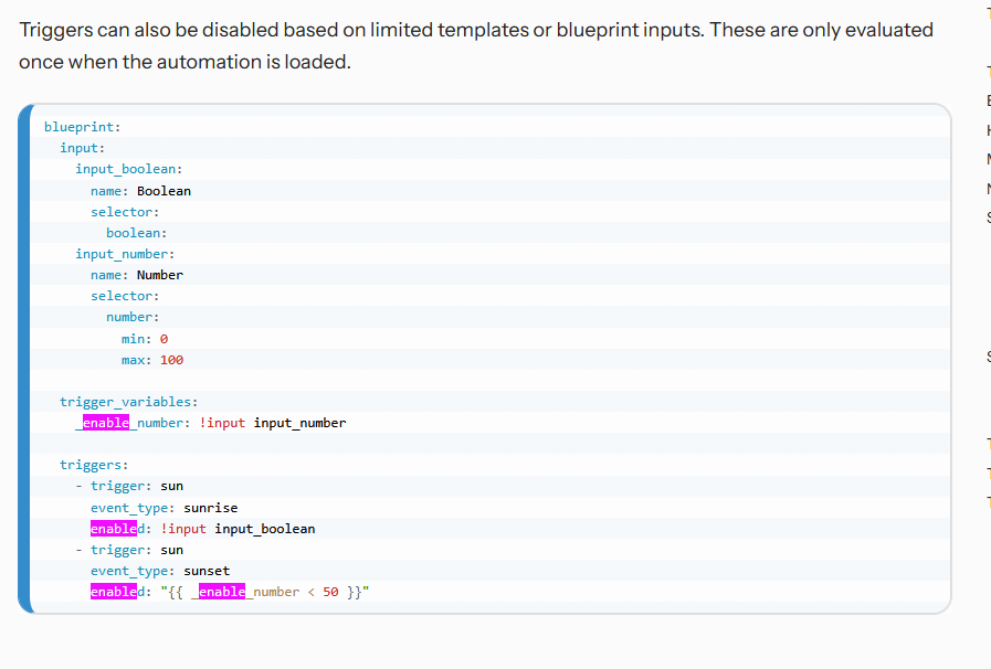

That's not possible in a single trigger. Your only option is to place the input into trigger_variables, then have 59 triggers, one with each time pattern. Then use the enabled field with a template to disable all the patterns that don't match the input one.

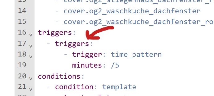

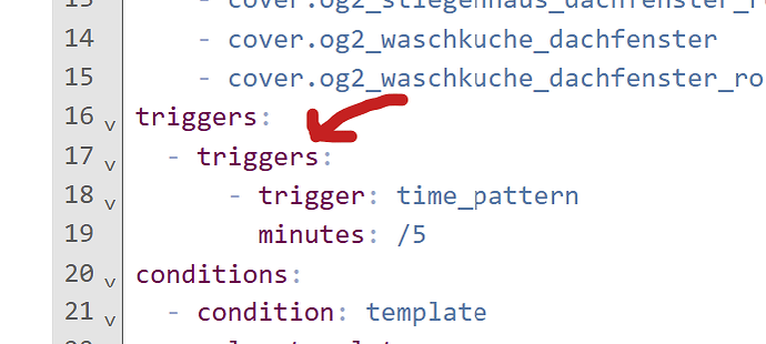

ohhhhhhh, not 'trigger' I have to use 'triggers', as the input selector is fixed to 'multiple: true' .. not very consistent, sorry to say this here ...
I was able to save the automation based on this BP so I guess, it will work ...
Edit: Yessssssssssss, triggeered as expected.
This 's' is very important, guys:
