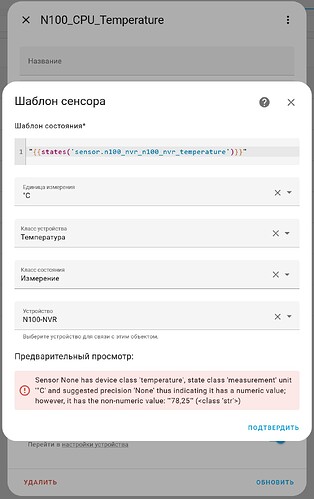

You should use the template suggestions above, but you should also remove the outer quotes from your template in the template editor. If you do not, they end up in the value for the state. Note the tripple quotes in the error message.
I thought to create another template sensor which will use this bare string, but will had temperature attributes. But I have error
“Sensor None has device class ‘temperature’, state class ‘measurement’ unit ‘°C’ and suggested precision ‘None’ thus indicating it has a numeric value; however, it has the non-numeric value: ‘«78 »’ (<class ‘str’>)”
Hah! Yes, that’s right, now it works! Thank you a lot!
