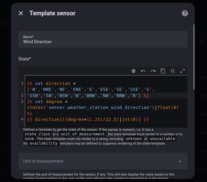

You don’t. Template sensors do not replace or overwrite their source(s). They are their own entities. If you want to be able to add the new sensor to the weather station device in HA you must set it up through the Helpers menu… YAML configured template entities cannot be added to devices at this time.
Can you point me in the right direction on how to make this in the helper menu? I tried to create a new helper and selected sensor. But pasting the YAML is not the correct way to make it work and I’m not sure what info the helper needs? Like what is the unit of measurement I need to select?
First, erase or comment out the old sensor config and reload Template Entities or Restart HA. This will prevent you from ending up with two of the same sensor.
In the Helper Menu click New Helper, select Template, then Sensor. Then you just put the value from the yaml in their corresponding fields in the Helper config flow. For the configuration above that means you put “Wind Direction” in the Name field and the template in the State field. Neither the Unit of Measurement, Device Class, nor the State Class fields apply to your sensor.
If you want to attach this sensor to your device you need to select it in the Select a Device field.
