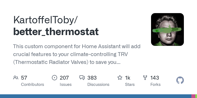

So far, I found this addon:
It is suitable if you control climate via radiator and AC, but not sure is it able to controll HVAC modes for AC (like dry and fan only), I asked about it.
