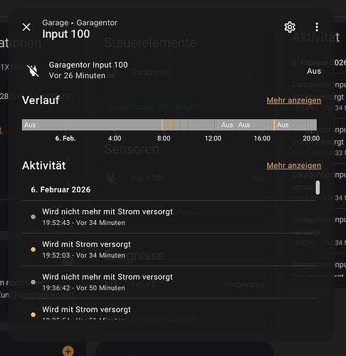

Sorry for the false wording. I corrected the post. That’s the only error I’ve found in the logs regarding the garage door:
