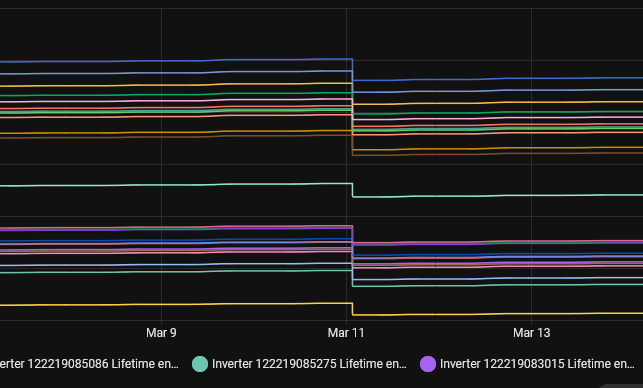

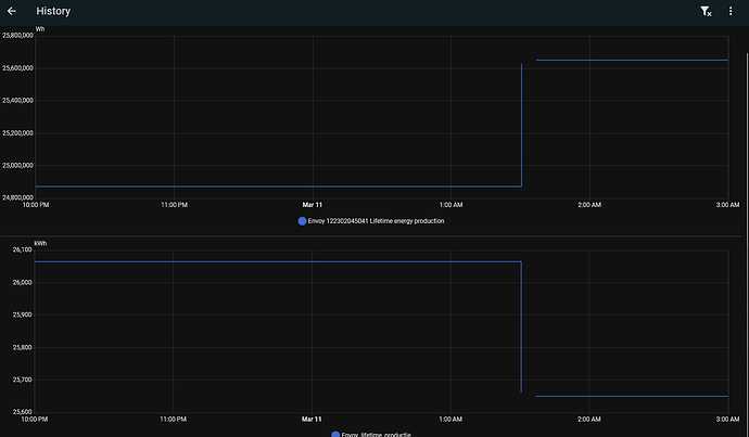

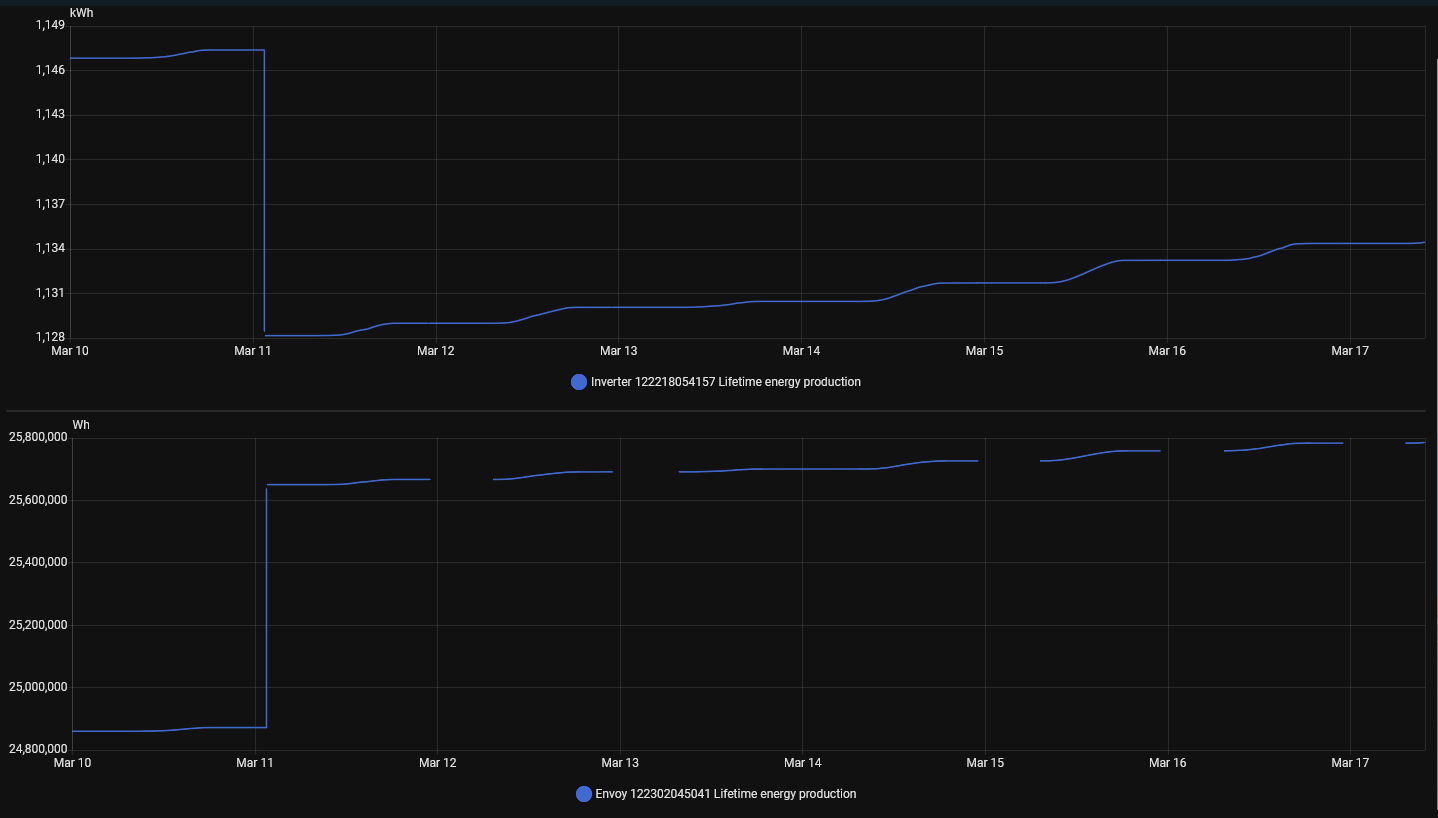

On march 11, all of my 24 inverter lifetime values all showed a step change of ~20 kWh down (total -414 kWh) and at the same time the Envoy lifetime value stepped up 778KWh.
As a result, my summed inverter lifetime and the Envoy lifetime values are equal again. Before they were offset by the 1.2MWh step down.
When comparing inverter lifetime to values shown in the Enphase portal, they now differ with the step down value of ~20kWh…
Interestingly, the 778 and 414 steps together are the 1.2 MWh magic number… As if the step down ‘repaired’ the earlier (but might come back again when thresholds are reached again)

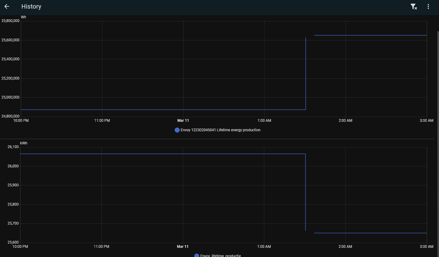

At the time of this happening there was an error and a data gap of 6 minutes (envoy restart!?) and right after it the warning that ever increasing values went down.
2026-03-11 01:30:31.831 ERROR (MainThread) [homeassistant.components.enphase_envoy.coordinator] Error fetching Envoy 122302045041 data: Error communicating with Envoy API on 192.168.3.112: HTTP status error https://192.168.3.112/ivp/pdm/device_data 502
2026-03-11 01:40:10.246 WARNING (Recorder) [homeassistant.components.sensor.recorder] Entity sensor.envoy_no_lifetime_productie from integration group has state class total_increasing, but its state is not strictly increasing. Triggered by state 12033.17 (12217.405) with last_updated set to 2026-03-11T00:36:57.778234+00:00. Please create a bug report at https://github.com/home-assistant/core/issues?q=is%3Aopen+is%3Aissue+label%3A%22integration%3A+group%22
2026-03-11 01:40:10.246 WARNING (Recorder) [homeassistant.components.sensor.recorder] Entity sensor.envoy_lifetime_productie from integration group has state class total_increasing, but its state is not strictly increasing. Triggered by state 25650.383 (26065.089) with last_updated set to 2026-03-11T00:36:57.813779+00:00. Please create a bug report at https://github.com/home-assistant/core/issues?q=is%3Aopen+is%3Aissue+label%3A%22integration%3A+group%22

Screenshots:
1 inverter and envoy lifetime step change:
All inverters step changing:
The step changes in the sum of inverters (-418) and envoy lifetime (+778)

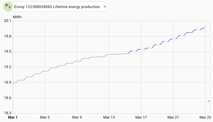

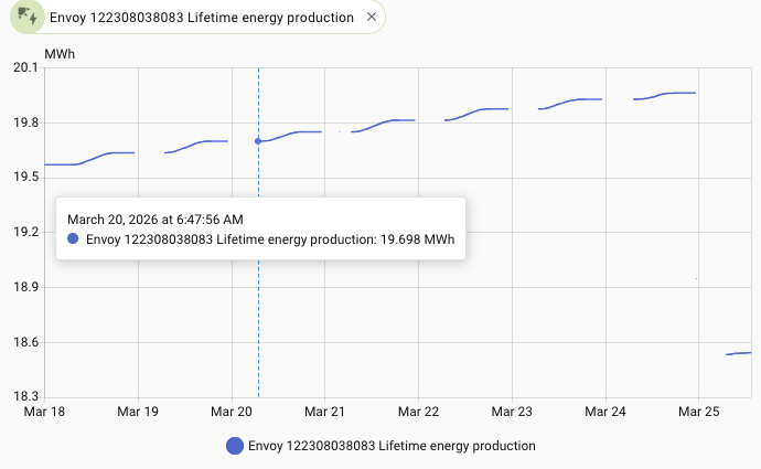

Weird, behavior here as well:
Drop by 1.4 MWh.
FW: 8.3.5286
Dropped yesterday, but my inverters are no-where near the max number.

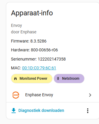

Not sure if firmware was updated recently. Any way to check?

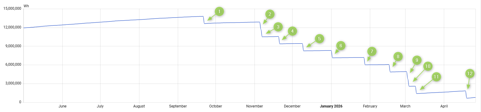

I found this thread whilst googling for similar issues to what I’m seeing.
It looks like my envoy has an issue that is getting worse over time. Has anyone else seen similar?
I understand that exceeding the capability of a variable would cause the value to roll-over, but that doesn’t seem to be what’s happening here - it doesn’t look like that, and I don’t understand why the steps appear to have become smaller and more frequent over time. This doesn’t look like a simple over-flow.
Any ideas?

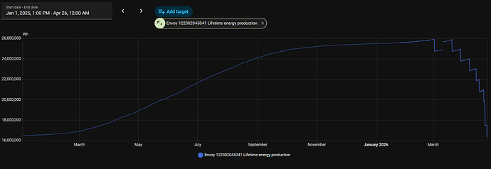

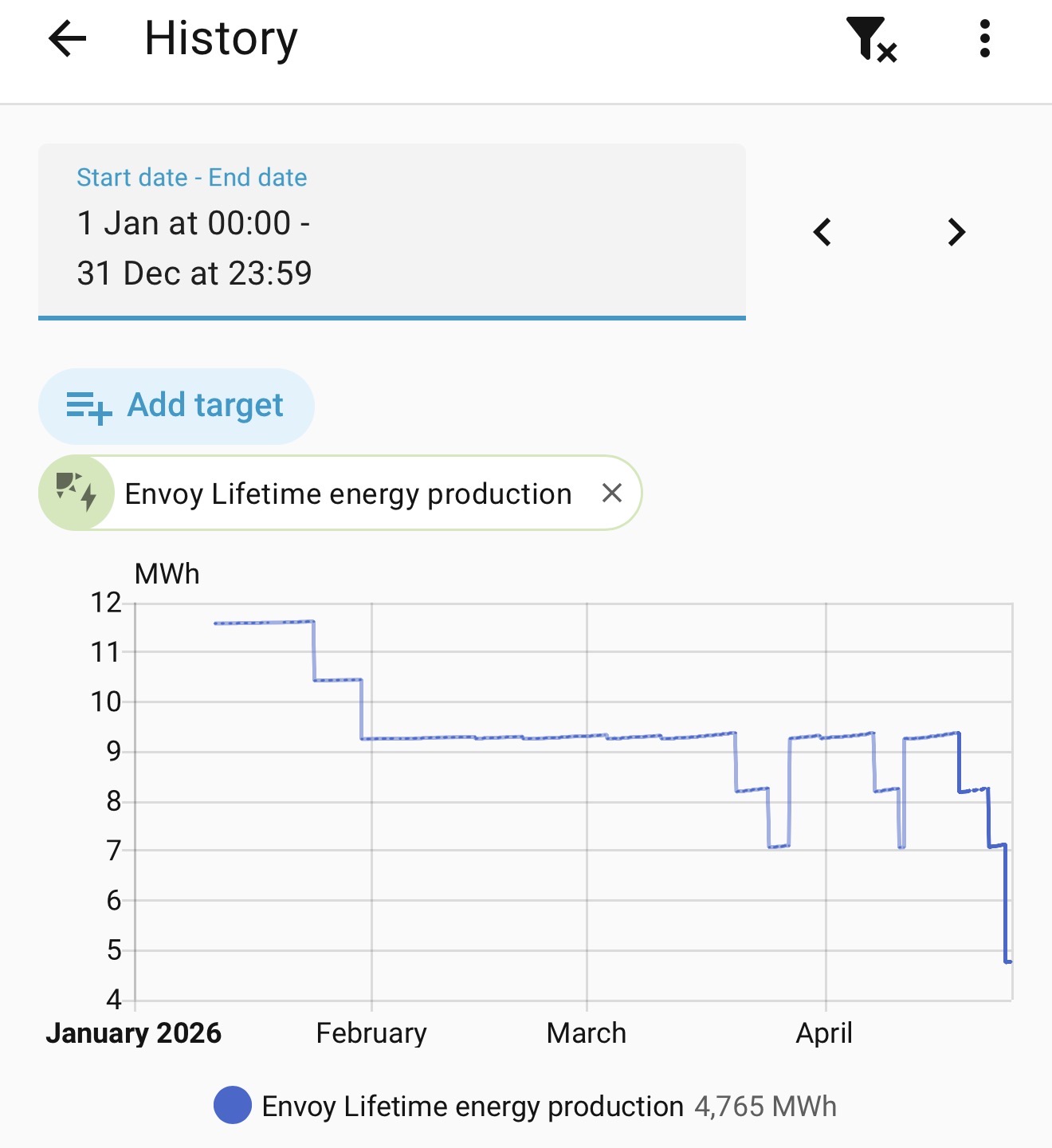

Also experiencing the same issue: occasional jumps of up to 14MWh per day and sometimes negative numbers. Did anyone find a fix?

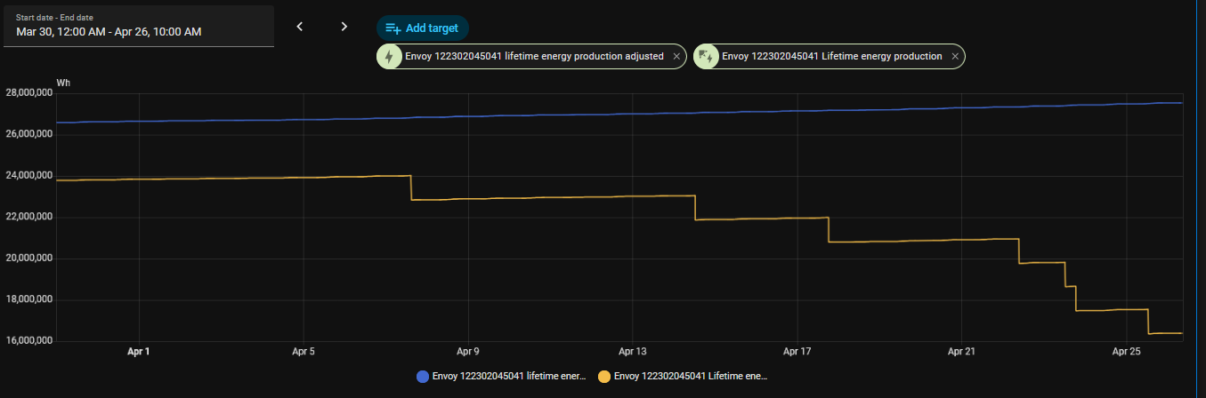

To make it even weider: find below the graph of my “Envoy lifetime production” sensor. This is probably caused by the frequent corrections that I had to make in order to keep my energy dashboard tidy (via developer tools → statistics-> outliers)
The step in 2025 may be unrelated to the steps in 2026. Was it same firmware then and now?
The 2026 pattern resembles what the blueprint is trying to handle. Check the size of the individual steps in 2026 (see values below). I’ve now had multiple steps, each time an inverter crossed the 1.19…MWh lifetime value.
The value roll-over of some internal value is an assumption based on the value. Could be coincidence of the values, we don’t know for sure. I’ve reported it to the (Dutch) Enphase support with multiple screenshots, they replied they would hand it to technical support…

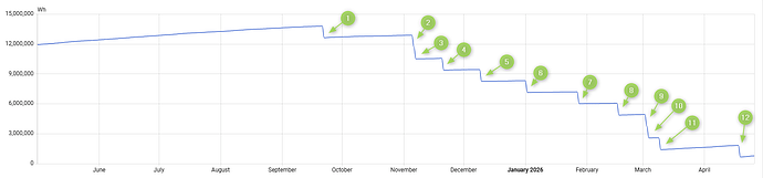

This is my lifetime since Jan1, 2025, steps downs started in march of this 2026.
Half om my panels are facing south-west, other half north-east and all installed at the same time. The south-west ones are after 3 year of production now one-by-one reaching the 1.19 MWh mark.
April showed 7 steps:
This weeks statistics corrections (see the matching values):
Think the statistics correction updates the sum field used by the energy dashboard in the statistics table and not the actual last value. I would expect to show actual value as it was received, see my screenshot in my previous reply. I did multiple corrections as well and it only shows correct in the energy dashboard, not in actual history.
I experienced a step up one time also (screenshot in previous reply) at the same time the lifetime production of the inverters stepped down. Do you see something similar?
Interesting. I didn’t have individual inverter lifetime energy production enabled for my 12 inverters, but I’ve enabled them today. All 12 are well over 1.19 MWh.
The most recent step down was just over two weeks ago, yet the inverter with the lowest energy production is currently at 2.4 MWh.
Looking back, it looks like all 12 of my inverters have reset/overflowed. I’ve found all 12 steps. Does this mean I’m good for another 9 years or so?
Well, if firmware doesn’t change, maybe only 4.5 year. If your lowest inverter lifetime value is 2.4MWh it means this time it was the second series of reset/overflow at 1.19 MWh that you just observed.
