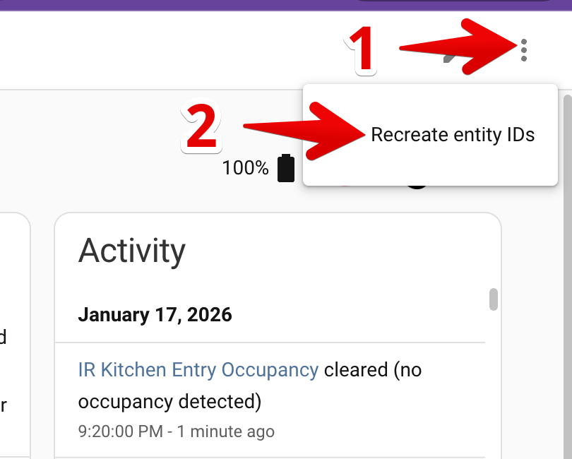

I believe this is the correct way:
  • Open the Device you wish to rename.
  • 1.> Click the pencil in the top right.
  • 2.> Enter a new “Name” for the device".
  • 3.> Click Update
Then you need to:
  • 1.> Click the 3 dots in the top right.
  • 2.> Select “Recreate Entity IDs”
That appears to update all the attributes of the device.
After doing that, check your automations/groups/scenes, since they will now have dead references that need to be fixed (delete the old name and add the new one).

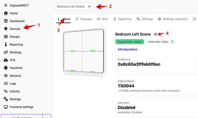

When I asked the question I was only using ZHA and WIFI (thats why I didn’t understand tom_I’s answer) for Z2M it’s easier to use the Z2M UI:
  1. Click Devices
  2. Select/Search for the device.
  3. On the “About” tab.
  4. Click the “pencil” next to the name.

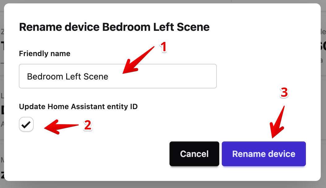

That brings up the rename dialog:
  1. Enter the new name.
  2. Check “Update Home Assistant entity ID”
  3. Click “Rename device”
If you use areas (and maybe some other HA specific functionality) you may want to confirm in the HA UI that the the extra meta data is correct.
