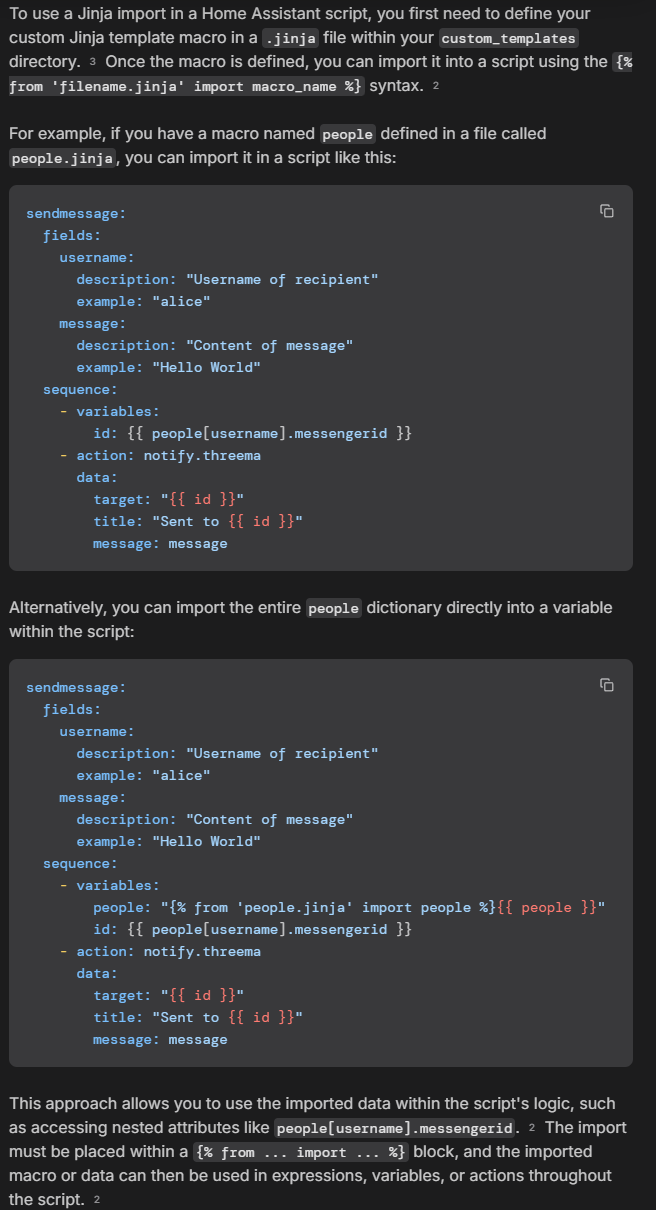

I just started Brave which opened the search page prefilled with my question about this topic. Today it responded with an AI generated answer that is obviously based on this thread.
That was quick
The first whole half of that is wrong. You have to import it, you have no choice.
You’re right, and that’s why I think AI is quite limited at this point in time.
I am still surprised this got picked up within hours
