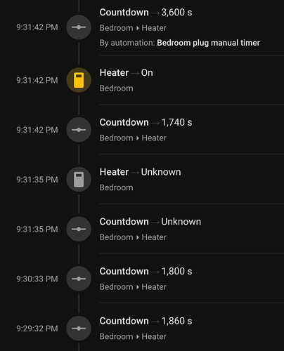

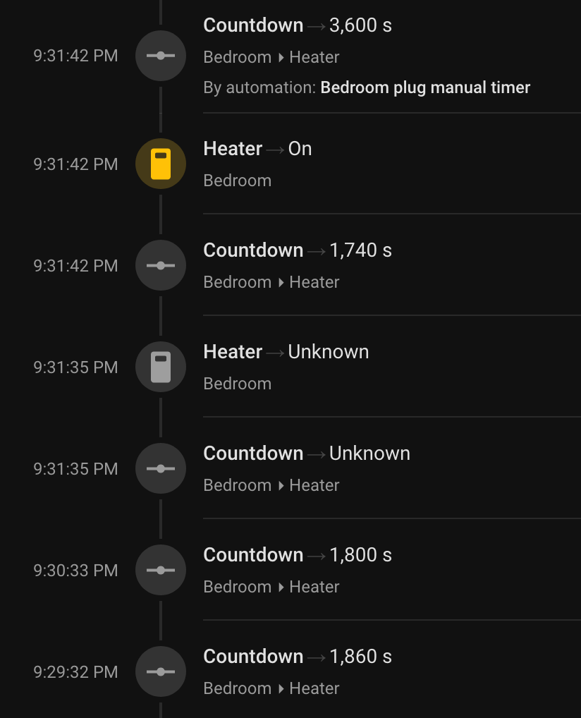

And here’s the activity. (I have a similar automation that does the same as the Overnight, but just at 9pm) So at 9pm it was turned on and that automation set the countdown to 1hr. Then at 9:30 I restarted HA & MQTT. You can see the switch be marked as on again at 9:31 which triggers the “manual automation” timer.
Is my best option to remove the countdowns from the night time automations and just leave it on the “manual automation”? What else am I misunderstanding?

@bob.t @busman Thanks both for that information. I don’t think my countdown itself is being lost by the restart of HA. As far as I can tell, that countdown is part of the device itself, so persists. However, when HA restarts, the plug state goes from an Unknown state to On (since the plug was on prior to the restart). This then triggers the automation to set the Countdown to 1hr.
There doesn’t seem to be a way to tell the difference between “the physical button was pressed” and “HA switched the plug on”. Does that sound right for this sort of device?
I think both a Timer helper or the Generic Thermostat could solve this problem though, but not relying on haphazardly applied coundowns - it just seemed like utilising the features of the device all in one place made sense and was tidier.
