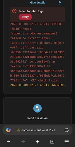

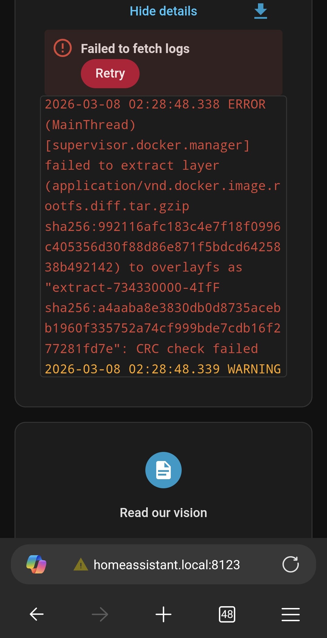

Tried a few things using Gemini to solve it, no joy, try and install 17.0, great that goes on all okay. Boot into HAOS and it tried to install 17.1 and it just doesnt want to play. I get this message in red:

Just wanted to come back with an update, been waiting on a new stick of RAM to arrive after doing a test using memtest86, the RAM was totally FUBAR. The test self aborted it was that bad so that explains the issue, because the system stores it in the RAM before sticking it onto the SDD and the RAM was corrupted it was failing the CRC.
