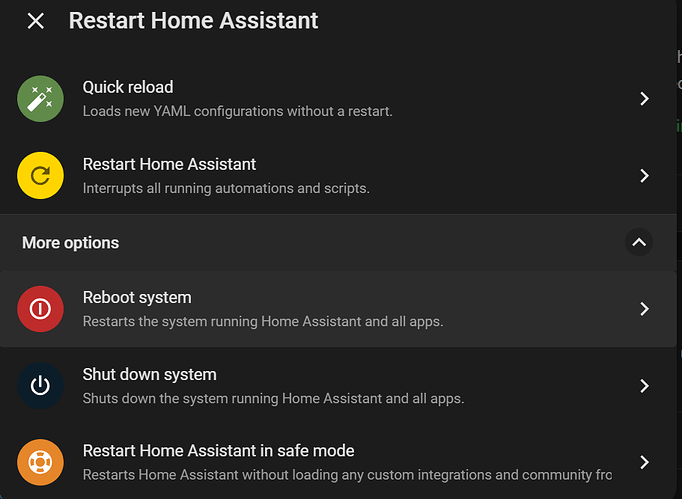

If you still can, download your backup to a different device & do a full reboot (not restart) from the More Options menu like the doc says.
Hopefully that should be enough, otherwise you’re gonna have to start over & restore from backup.
Thank you very much! It worked!
I no longer have an error message.
