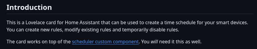

As stated in the card repo…
… that card requires the Scheduler custom compnent, did you download and install that as well?
