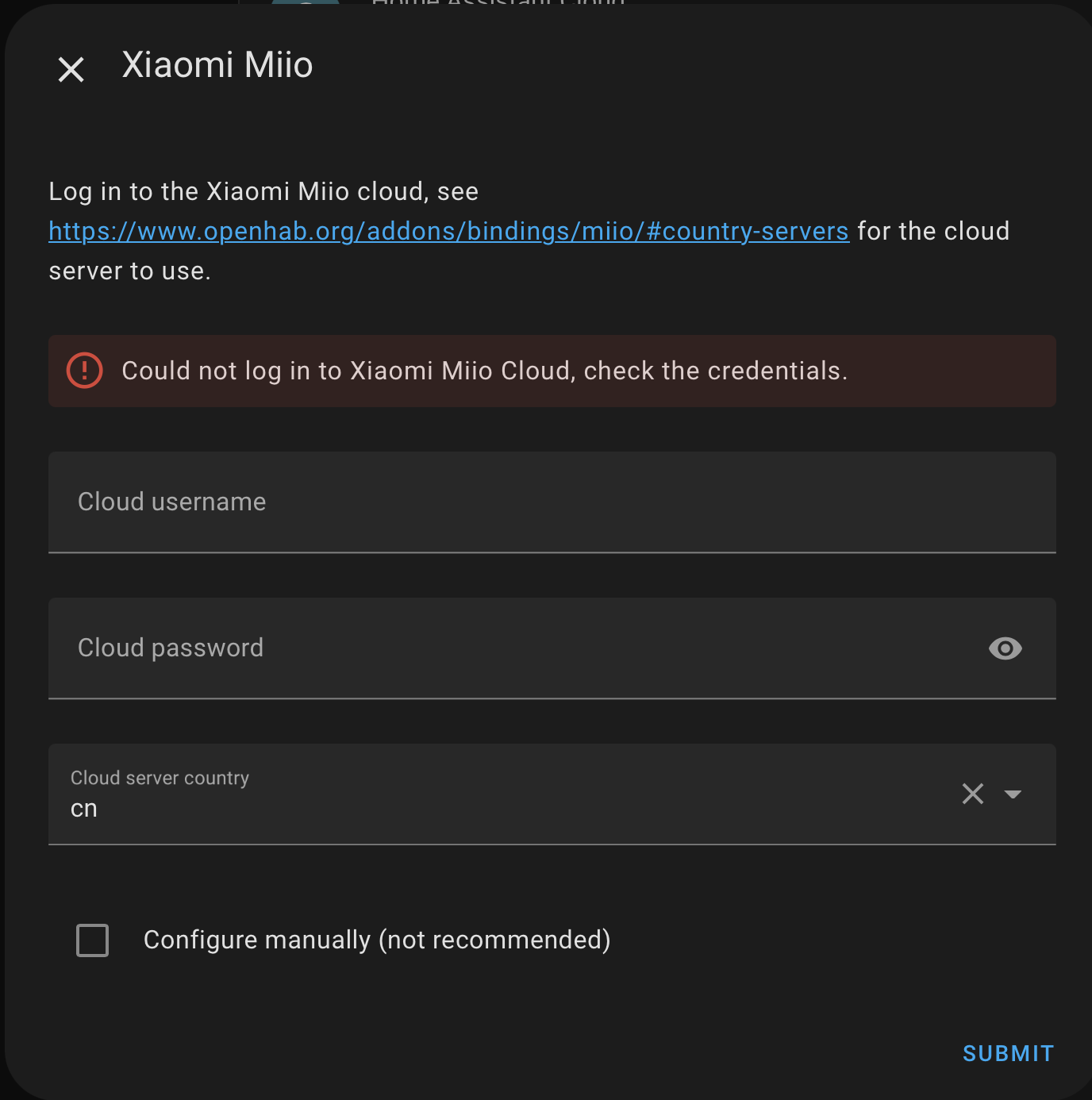

After restart I lost connection to Xiaomi cloud, and since then I can’t login anymore, it’s the xiaomi miio integration, anybody experience similar problem?
I’m 100% sure the username/password/server is correct and I can login to xiaomi app and website

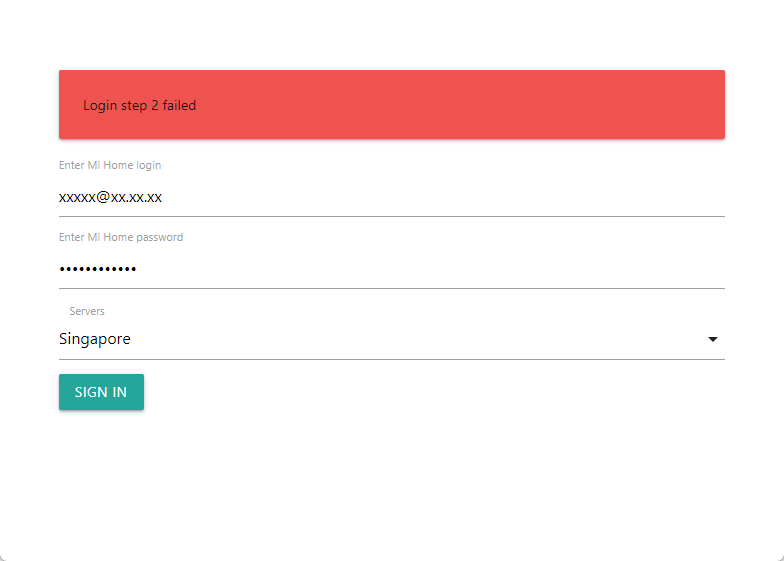

However using the Token extraction tool, I do get an error, which hints to a multifactor authentication type of solution

Yes the same problem for me with token extract tools, maybe Xiaomi changed login API.

I successfully retrieved the API token using the code changes presented in this issue:
opened 08:15AM - 18 Jun 25 UTC
I’m running into a login failure that’s misreported by the script. When trying t… o authenticate, the script reports “invalid login or password,”. But this made no sense, since it had worked the day before.
So I added some debugs in the code, and I got a response from Xiaomi’s server containing "description": "验证码输入错误" and a captchaUrl field. That error means “Captcha input error” in Chinese.
[DEBUG] login_step_2: URL: https://account.xiaomi.com/pass/serviceLoginAuth2
[DEBUG] login_step_2: Fields: {'sid': 'xiaomiio', 'hash': '<redacted>', 'callback': 'https://sts.api.io.mi.com/sts', 'qs': '%3Fsid%3Dxiaomiio%26_json%3Dtrue', 'user': 'XXXXX', '_sign': '0psXfr43eNI0IX6q9Suk3qWbRqU=', '_json': 'true'}
[DEBUG] login_step_2: Response text: &&&START&&&{"qs":"%3Fsid%3Dxiaomiio%26_json%3Dtrue","code":87001,"description":"验证码输入错误","securityStatus":0,"_sign":"0psXfr43eNI0IX6q9Suk3qWbRqU=","sid":"xiaomiio","result":"error","captchaUrl":"/pass/getCode?icodeType=login&0.3094213243055923","callback":"https://sts.api.io.mi.com/sts","location":"","pwd":0,"child":0,"desc":"验证码输入错误"}
[DEBUG] Downloading captcha image from: https://account.xiaomi.com/pass/getCode?icodeType=login&0.3094213243055923
[INFO] Captcha image saved at: C:<redacted>\Local\Temp\tmp5eh0517g.jpg
Enter captcha as shown in the image: <redacted>
So to fix this, I made a function that gets the captcha, and shows it to the user with Pillow, then asks for an input. After that, the script resends the login request with the captcha code included and everything works.
I’ve already patched this in my own code and can submit a pull request if you want. Let me know if you’re interested.
Working correctly now.

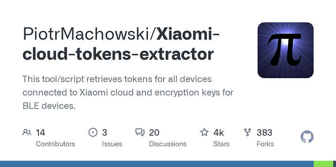

This tool/script retrieves tokens for all devices connected to Xiaomi cloud and encryption keys for BLE devices.
After I got the IP and Token of the device that I need, i used back the Xiaomi Home app and select ‘Configure manually (not recommended)’ and click submit. No username and password is required. On the next screen, key in your device IP and Token and they will be re-authenticated. I believe this only works for devices that are run locally.
