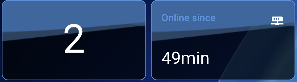

That’s my solution:
- platform: history_stats
  name: "DSL Disconnects"
  entity_id: binary_sensor.fritz_box_7590_connection
  state: "off"
  type: count
  start: "{{ now().replace(hour=3, minute=0) }}"
  duration:
    hours: 24
- platform: template
  sensors:
    dsl_reconnected_last:
      unique_id: dsl_reconnected_last
      icon_template: mdi:router-network
      value_template: >-
        {%- set last_boot = states('sensor.fritz_box_7590_connection_uptime') %}
          {%- if last_boot in ['unavailable', 'unknown'] or last_boot is none %}
            unknown
          {%- else %}
            {%- set uptime = now().timestamp() - as_timestamp(last_boot) %}
            {%- set time = uptime | int %}
            {%- set minutes = ((time % 3600) // 60) %}
            {%- set minutes = '{}min'.format(minutes) if minutes > 0 else '' %}
            {%- set hours = ((time % 86400) // 3600) %}
            {%- set hours = '{}h '.format(hours) if hours > 0 else '' %}
            {%- set days = (time // 86400) %}
            {%- set days = '{}d '.format(days) if days > 0 else '' %}
            {{ 'Less than 1 min' if time < 60 else days + hours + minutes }}
          {%- endif %}
