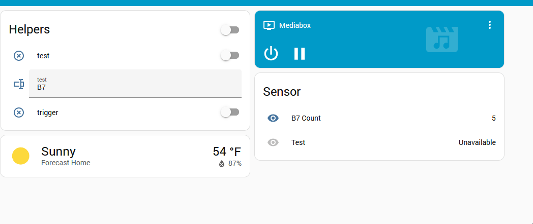

Working for me :man_shrugging:
Keep in mind, with input texts, you need to click enter on your keyboard to enter the state.
firefox_hlATzETs06
Tom meant you used the wrong entity ID in the code.
It should not be input_text for OP.
The input text code was just mine for testing, as you also did.
But for OP the code should be the sensor…

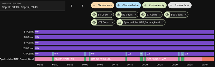

hi @tom_l the try with 0.5 increment didn’t worked
  - name: "B7 Count"
    unique_id: "B7_count"
    state: >
      {% if this is defined %}
        {% if 'B7' in states('sensor.zyxel_cellular_intf_current_band') %}
          {{ this.state|int(0) + 0.5 }}
        {% else %}
          {{ this.state|int(0) }}
        {% endif %}
      {% else %}
        0
      {% endif %}
  - name: "B1 Count"
    unique_id: "B1_count"
    state: >
        {% if 'B1' in states('sensor.zyxel_cellular_intf_current_band') %}
        {% else %}
        {% endif %}
      {% else %}
        0
      {% endif %}
now I get even less sensors incremented and the max is the value 0.5
