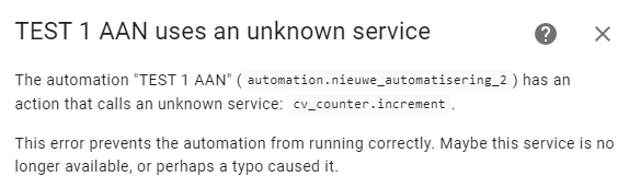

First time i try to use a counter.
In developer tools - services, i can increment this counter
In an automation, this exact service is not executed.
Error message:
This is the automation in yaml:

Any idea what i’m doing wrong here?
action:
  - service: counter.increment
    data: {}
      entity_id: counter.cv_counter
mode: single
Yes that solves it. I did not look at the complet yaml until i copied it to include here. In the visual editor this is not visible. Also not visible when editing the action in yaml.
