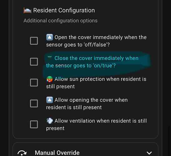

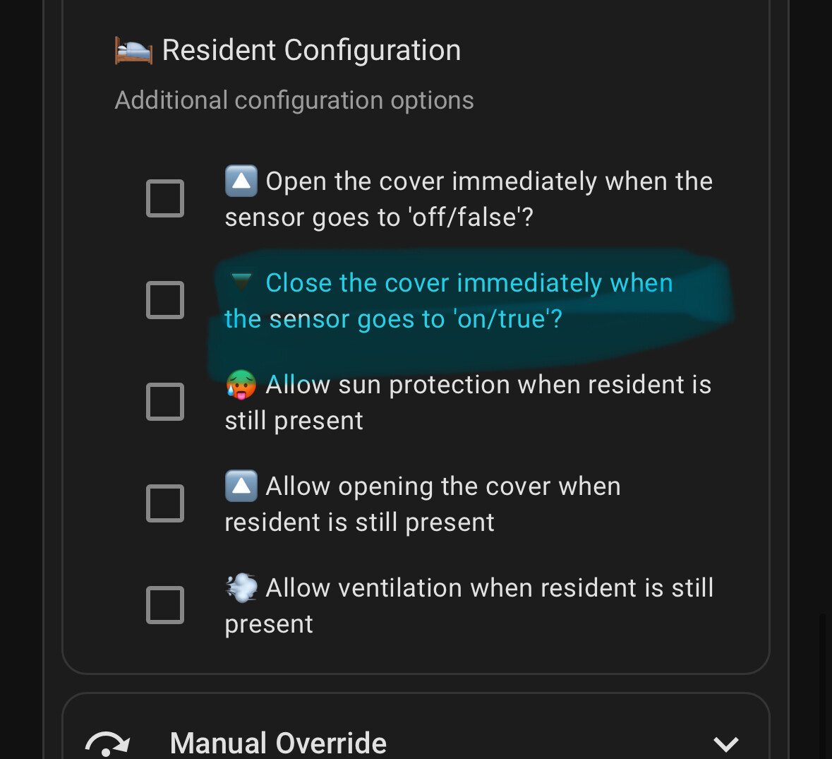

what does the option “Enable generic automatic opening/closing of the day in the morning/evening” actually mean?
I haven’t configured anything else except for a CCA Helper. This morning, my test roller shutter did not open automatically. With this setting enabled, when exactly should it have opened? What triggers the timing for opening/closing?
Thanks in advance!
