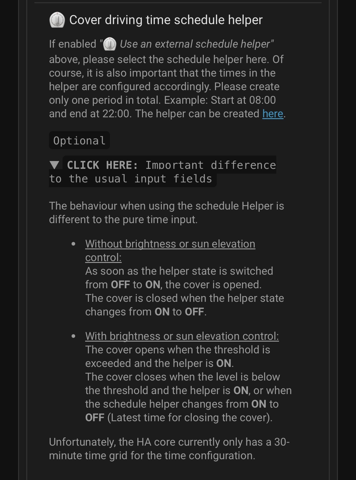

Hi @Herr.Vorragend ,
I adapted the config to
time_up_late: "10:00:00"
time_up_late_non_workday: "10:00:00"
time_down_early: "18:00:00"
time_up_early_non_workday: "06:00:00"
time_down_early_non_workday: "18:00:00"
time_down_late: "23:59:00"
time_down_late_non_workday: "23:59:00"
The schedule assistant has been adjusted to display a bar daily from 6:30 AM to 11:59 PM.
The problem persists: The blinds open in the morning but do not close in the evening. Here’s the history of the sun event at 4:34 PM. I would expect this to be correct, as it is still early. However, I expect them to close at 6:00 PM. No further events have been triggered so far.
BR

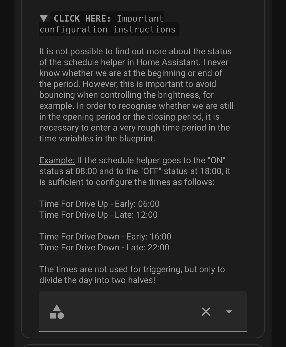

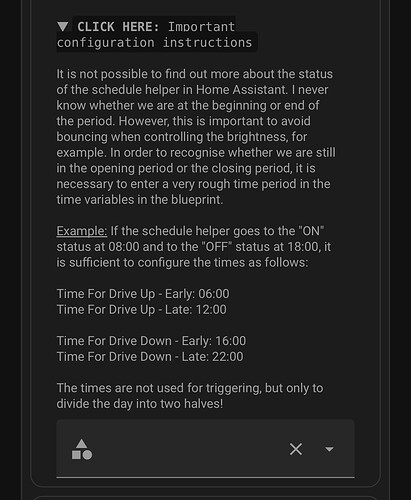

Oh, now I see it. That took a while.
Your Time Down Early is set too late. When using the scheduler, you only need to split the day in half.
The trigger came before 6 p.m. and you only allow it from 6 p.m. onwards.
Change the value to 2 p.m.
And I urgently need to revise this. Hardly anyone can understand it, even though it is actually documented.
Does this mean I need to adjust the schedule so it has two bars per day – for example, 6:30 AM to 2:00 PM and 2:00 PM to 11:59 PM? Or do I need to adjust the value for “time_down_early”? Or maybe both? For some reason, I don’t understand what the schedule is even for.
I divide the time period into two segments per day and try it out: 6:00 AM–2:00 PM | 2:00 PM–11:59 PM.
If I set the time for “time_down_early” to 2:00 PM, the shutters could close as early as 4:00 PM due to sunset. That’s exactly what I want to avoid in the winter months, as it’s too early then - so I set the earliest closing time later. At least, that’s how I understand it. But I still don’t understand what this schedule is actually for. :thinking:

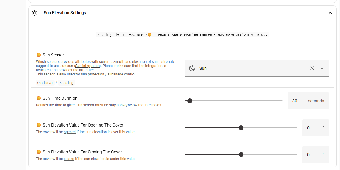

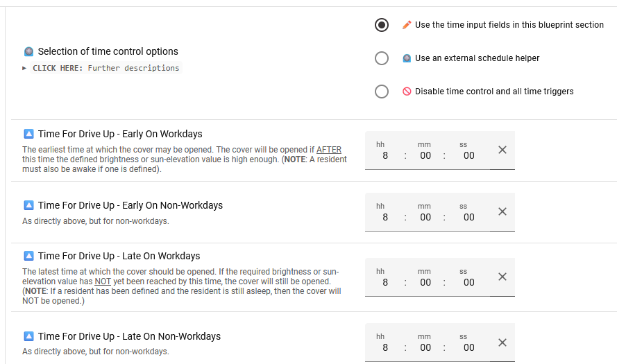

Hello everyone,
I have been using this Automation since May this year and I am really happy with it. Thank you! However, I’m stuck with one thing.
Currently, the roller shutters open at 08:00. Of course, just as I configured it :wink:
But at that time, due to winter here in Germany, the sun hasn’t risen yet and it’s still dark outside.
Previously, in my self-made NodeRed scripts, I always set it up so that at 8 o’clock it checked whether the sun had already risen. If yes, the shutters opened; if not, it waited until the sun had risen.
This should be possible with the Blueprint as well, but I don’t understand how…
Best regards

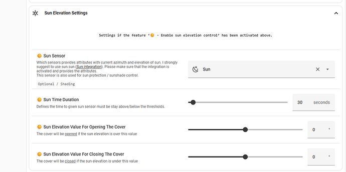

Look at the first screen shot in post #1. I would say that you would need the sun elevation option ticked.
Thanks for the hint — I had already selected that…
Take a look at the documentation here.
However, I will probably change this in the next update.
The roller blind will open here at 8:00 a.m.
The position of the sun is controlled between the Early+Late times. So always at the latest at the Late time.
It will be tight with the sun for you, as you have both times set to the same time.
that was my mistake. I simply skimmed over it. It’s clearly written in the description…
Thanks for your hint!

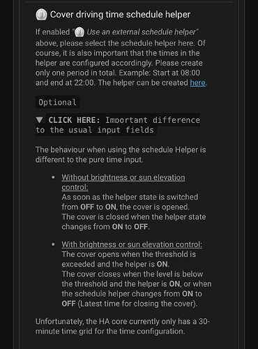

Hello @Herr.Vorragend,
Thank you for your feedback. This means that I need to use ONE sequence in the scheduler again and define the start and end times in the CCA automation for each roller shutter accordingly. For example:
time_up_late: "08:00:00"
time_up_late_non_workday: "09:00:00"
time_down_early: "17:00:00"
time_up_early_non_workday: "07:00:00"
time_down_early_non_workday: "17:00:00"
My question: How can I configure the shutters so that they don’t close as early as the sun event? According to The Sun, sunset is already shortly after 4 p.m., which would currently be too early. But setting an early down time to a later one doesn’t seem to work.
Unfortunately, it was already too late yesterday when I made the changes, and the events from Sun had already been triggered. I’ve now set the “down early” times earlier than the events from Sun. “Down early” = 4:00 PM, event around 4:30 PM.
    time_up_early: "06:00:00"
    time_down_early: "16:00:00"
    time_down_early_non_workday: "16:00:00"
The scheduler is again a sequence from 6:00 AM to 11:59 PM. I’ll report back on whether it works now.

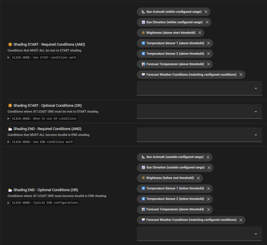

:sunny: Flexible Shading Logic - AND/OR Condition Builder
This is where things get seriously powerful! You now have full control over shading conditions:
New capabilities:
  • :white_check_mark: Separate START and END logic - strict criteria for starting, relaxed for ending (or vice versa!)
  • :white_check_mark: AND conditions - “ALL must be true” (e.g., sun position + brightness + temperature)
  • :white_check_mark: OR conditions - “AT LEAST ONE must be true” (e.g., redundant temperature sensors)
  • :white_check_mark: Per-condition on/off switches - enable/disable individual triggers independently
  • :white_check_mark: Unified retry behavior with configurable timeouts
Example configurations:
Conservative: AND(azimuth, elevation, brightness, temp) + OR(none)
Flexible: AND(azimuth, elevation) + OR(brightness, temp1, temp2)
Aggressive: AND(azimuth) + OR(brightness, temp1, forecast)
You can now fine-tune between conservative and aggressive sun protection without changing sensors! :art:

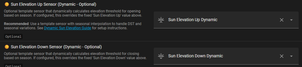

:chart_with_upwards_trend: Dynamic Sun Elevation - Set & Forget
No more manual adjustments for DST or seasonal changes! :tada:
The problem: Fixed sun elevation thresholds don’t work year-round. Winter sun stays lower, summer higher.
The solution: Optional template sensors that automatically adapt thresholds to the season using sinusoidal interpolation.
Benefits:
  • :white_check_mark: No DST adjustments needed
  • :white_check_mark: Year-round optimization
  • :white_check_mark: Covers open/close at consistent solar times
  • :white_check_mark: Smooth transitions throughout the year
  • :white_check_mark: Configure once, works forever!
Check out the new Dynamic Sun Elevation Guide for setup! :books:

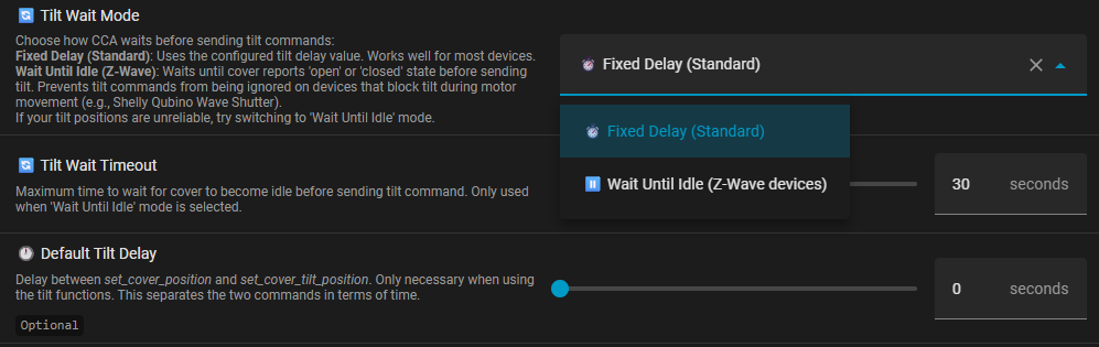

:arrows_counterclockwise: Tilt Position - Wait Until Idle Mode
Z-Wave users, this one’s for you! :dart:
The issue: Some Z-Wave devices (like Shelly Qubino Wave Shutter) block tilt commands during motor movement, causing unreliable tilt positioning.
The fix: New “Wait Until Idle” mode that monitors cover state before sending tilt commands!
Configuration:
  • Tilt Wait Mode: “Fixed Delay” (default) or “Wait Until Idle”
  • Tilt Wait Timeout: Maximum wait time (default: 30s)
Benefits:
  • :white_check_mark: Reliable tilt without manual delay tuning
  • :white_check_mark: Fully backward compatible
  • :white_check_mark: Timeout protection with warning logs
No more guessing delay values - CCA waits intelligently! :stopwatch:
