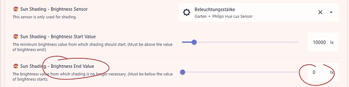

Unfortunately, ending shadowing still hardly ever works for me. :frowning:
Shadowing doesn’t start in one room either.
The same thing happens to me. The shading doesn’t end or doesn’t even start. The azimuth end isn’t taken into account. The strange thing is that a few versions ago, everything worked without any problems.
To the people who have problems with shading: which version do you use?

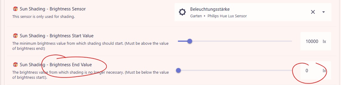

I’m currently considering changing a completely new feature because the shading is now even being executed too often.
What is the intended value for brightness end of I may ask?
Version: 2025.07.30
Have you seen my reply on Shading not ending when condition changed in previous waiting time ¡ Issue #258 ¡ hvorragend/ha-blueprints ¡ GitHub? Not sure because the issue is already closed.
