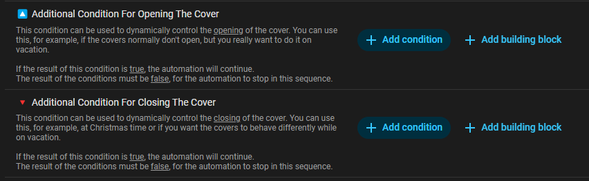

I was reading the setting again and there is a section under the “additional conditions” section
“Additional Condition For Opening The Cover”
and
“Additional Condition For Closing The Cover”
These seem like they would allow me to add the upper and lower magnet door sensors to the cover control logic, am i reading this right?
Chris
EDIT:
after reading this, it says the input must be FALSE. so no go there.
It seems strange there is no setting to be able to use the limit switches.
